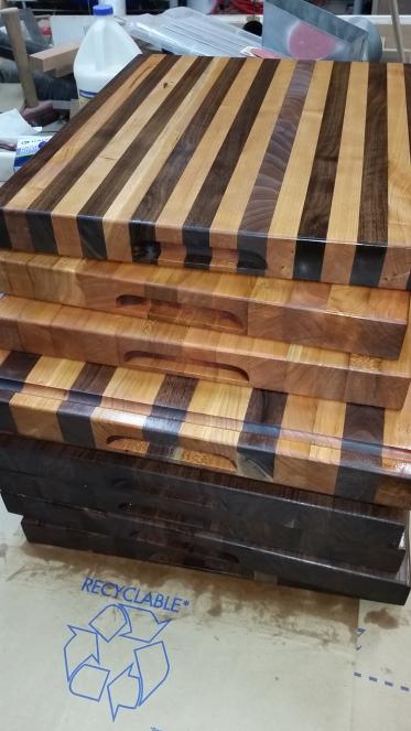

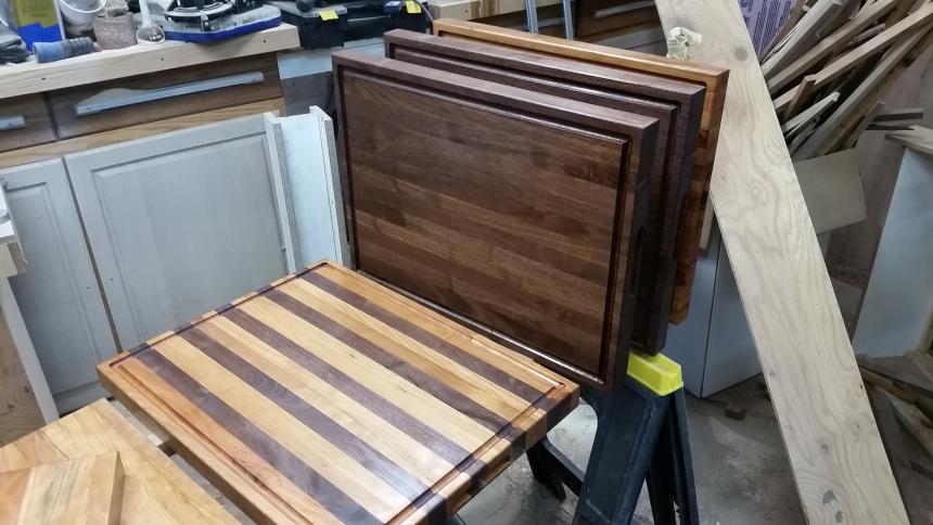

      The large boards are generally (none are the same size) 15x20 and the smaller ones are around 12x15. I only routed juice grooves in the large boards. The hand holds were routed using a 1/2" cove bit. The boards can be used on both sides but the rounded side of the handhold indicates the "top" with the better looking grain.
      I've got one generous slathering of mineral oil on here now. I'll do a coat each night through Friday. I made 9 total not because that's how many families I'm gifting to (although it's close) but because this is how much "scrap" I milled.

              I made one cutting board last year. For that handle, I used my router's edge guide and plunged a core box bit into the end grain. Worked well. When I tried it last night, not so much. The router got tippy and I didn't route a straight groove. I'm thinking last year I must have clamped on an extra board to widen the base. So that board lost an inch of length and I went to the router table with the cove bit. The cove bit gave a nicer profile and it was definitely easier to cut on the table rather than free handing it with the core bit.
              Routing the end grain wasn't a problem but since I had already invested so much time into these I was REALLY careful to think through the operation. Careful layout lines on the boards and the router fence. A few trial runs with the router off to make sure nothing was in the way. There are some burn marks in the corners of some of them and some of my juice grooves have burns--especially the cherry ones--but I know if I tried to "fix" them by raising the bit a hair, I'd eventually bugger them so I called it a day and now they truly look homemade.

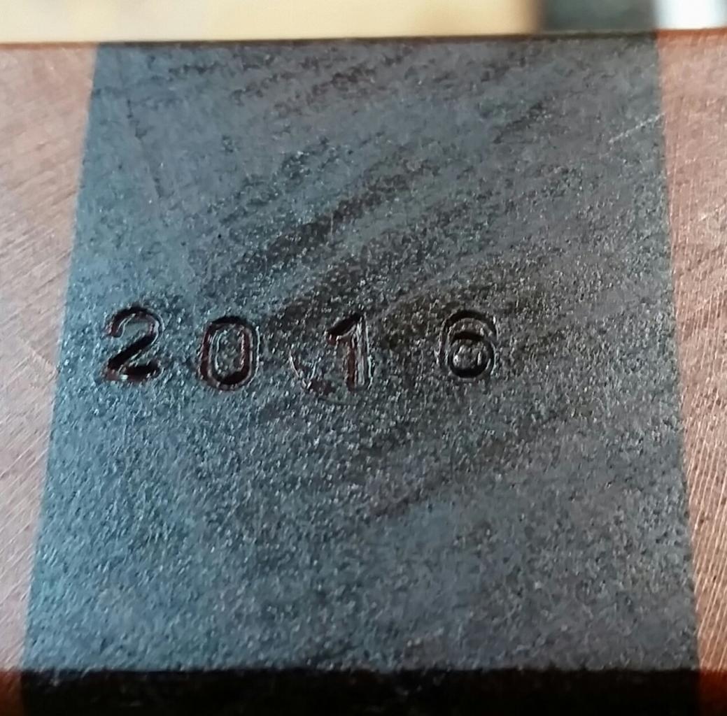

                        After I waxed the boards last night (I had a beeswax and mineral oil mix from before), I decided to further customize the boards

                          For quick lining up the number punches I clamp a bottom guide to the work. Some of the letters/numbers are not vertical w.r.t the flat sides on the cheapo eBay sets but in general I can get a better bottom horizontal line and better vertical alignment using the bottom guide. As letters have different widths, its still a trick to get the horizontal spacing good.Gotta be real careful with the I and numeral "1".
