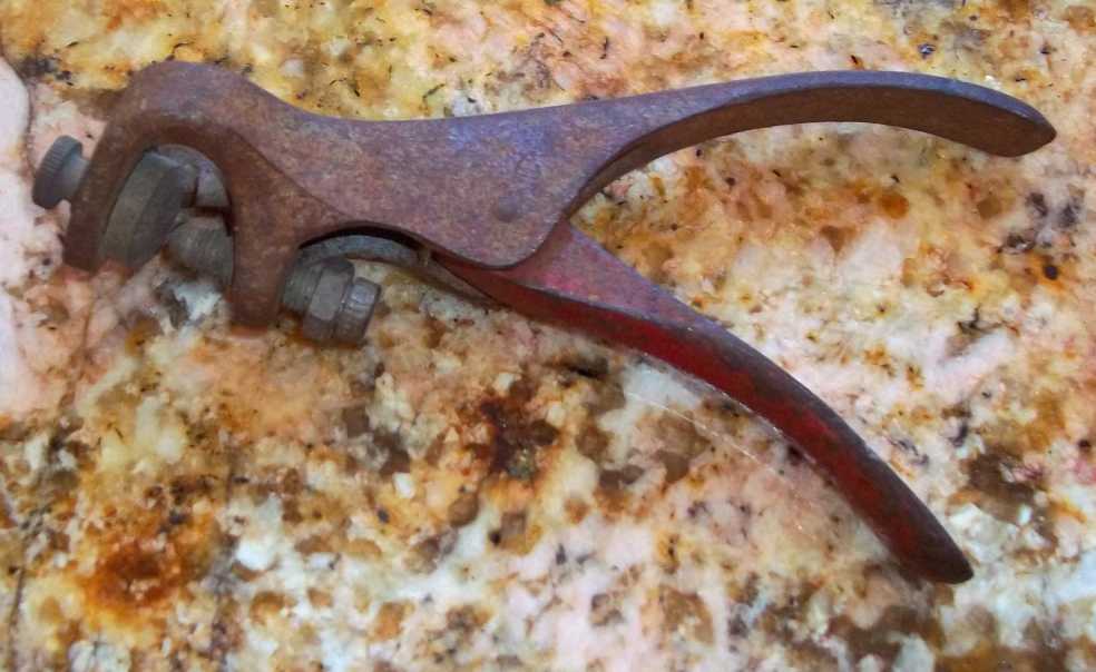

    What is it?
    Found one of these organizing my FIL storage shed.
    I know what it is but how many of you do off hand?
    It is made by Dunlap. Number on it is 4880.
    No fair if you had to look it up. Just want to see how many know without Google.
    It's a saw-tooth setter.

      It looks a lot like a saw tooth setter to me too, but the adjustment screw and the pad (the receiver for the adjustment screw) seem a bit large for that purpose... so if not for a hand saw, I don't know.
      Made by "Dunlap" makes me think of tires though.

        Saw Set
        Looks like a saw set for a two man saw. Dunlap was a sears brand a little cheaper than craftsman.

          Looks like a contraption to me!
          Seriously though, I have never seen anything like that, BUT since is it made by Dunlop, it looks like it might be something that sets the rubberized valve stem on a tube - back when people did those things.

            It is a saw tooth setter.
            Dunlap did make lawn mowers and stuff for Sears as well as specialized and assorted types of hand tools. Dunlop makes tires and tennis balls.
            I never actually used one of these but asked my Grandfather what his was for when I was a kid. It's a saw tooth setter was his reply. I asked no further then.

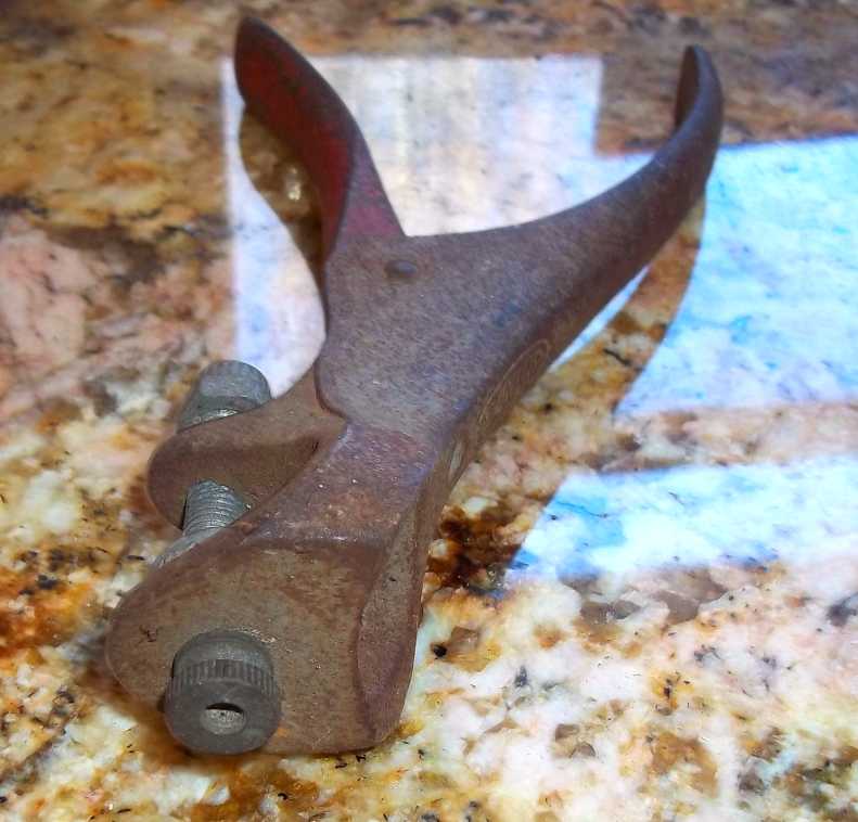

              The way this works is the top knob adjusts the different degrees of set. It has a flat plane in the center and varying pitches around the dial.
              The lower jaw tightens up on the blade to keep it flat.
              Then when you squeeze it, the die or plunger pushes against the tooth to the angle set on the dial. Do every other tooth on one direction. Flip around and repeat in the other direction.
