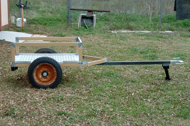

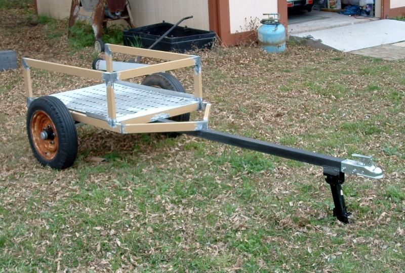

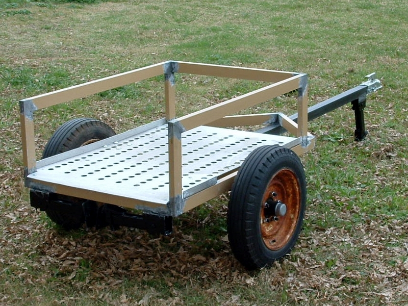

            Made a call today to inquire about putting an ID # on the trailer and found out it has to be issued by Texas DOT within 30 days of the sheriff's inspection/certification that it is not a stolen trailer. That was done on 30 Jan, so I am still good. I'll make a run to Austin either Thu or Fri to get the number issued, then swing by the county tax office get the plate.
            Except to add the number to the frame and a little bit of minor tweaking, it's ready to paint.

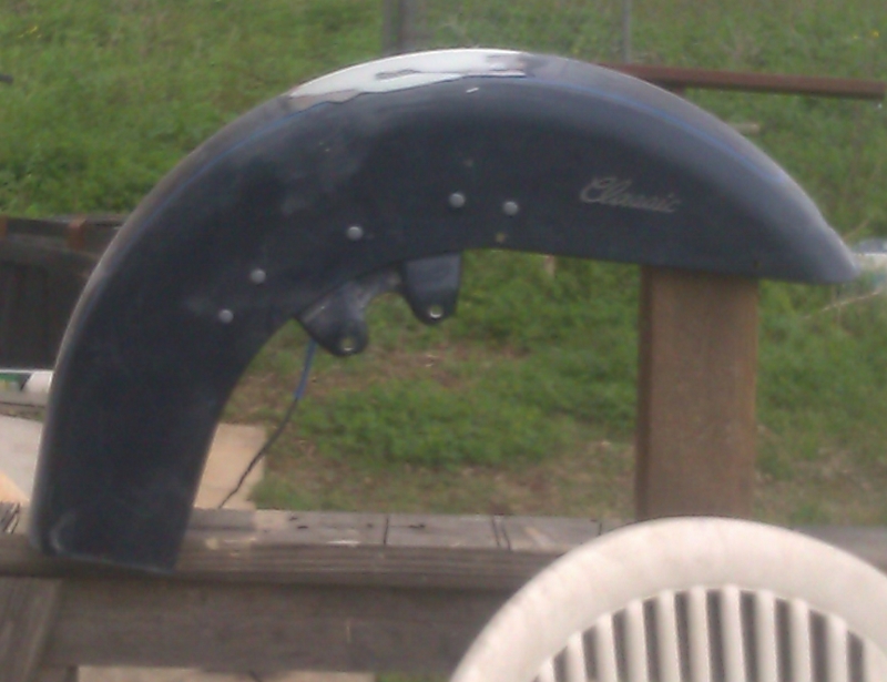

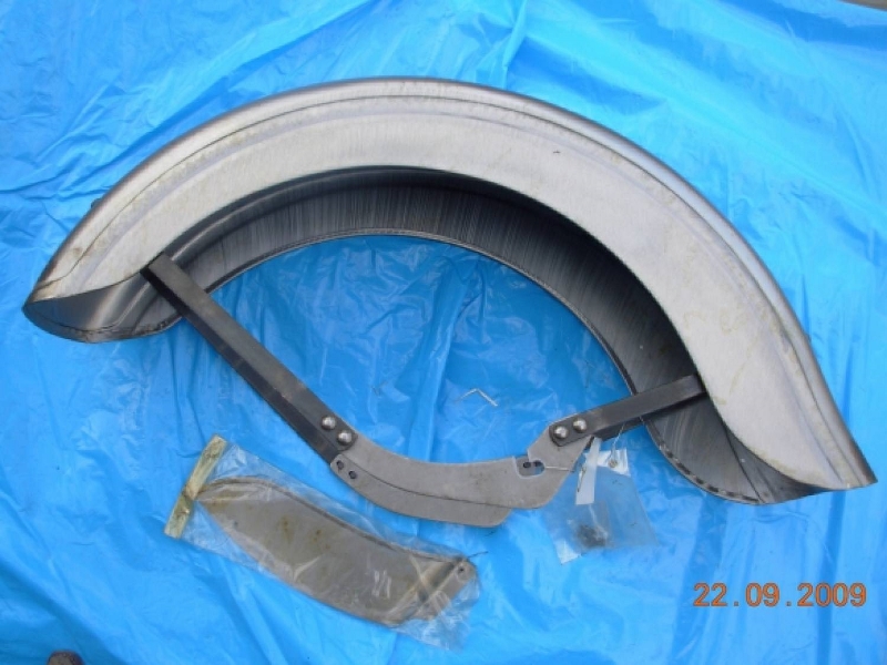

                  I couldn't find any trailer fenders I liked, other than plastic, and they wouldn't be strong enough to support the matching Tombstone tail lights so it was out to the shop to build a mold for custom fiberglass fenders. Since the trailer will only be pulled by the trike, I wanted fenders that would be similar in appearance to a Harley front fender. Think I got close.

                  Still have a lot of hand sanding to get the mold smooth before I can start to lay up the lay up the fiberglass. Once it is ready I will put on several coats of urethane to seal it and apply a liberal coat of paste wax as a release agent. Still haven't figured out the best way to attach them to the trailer.
