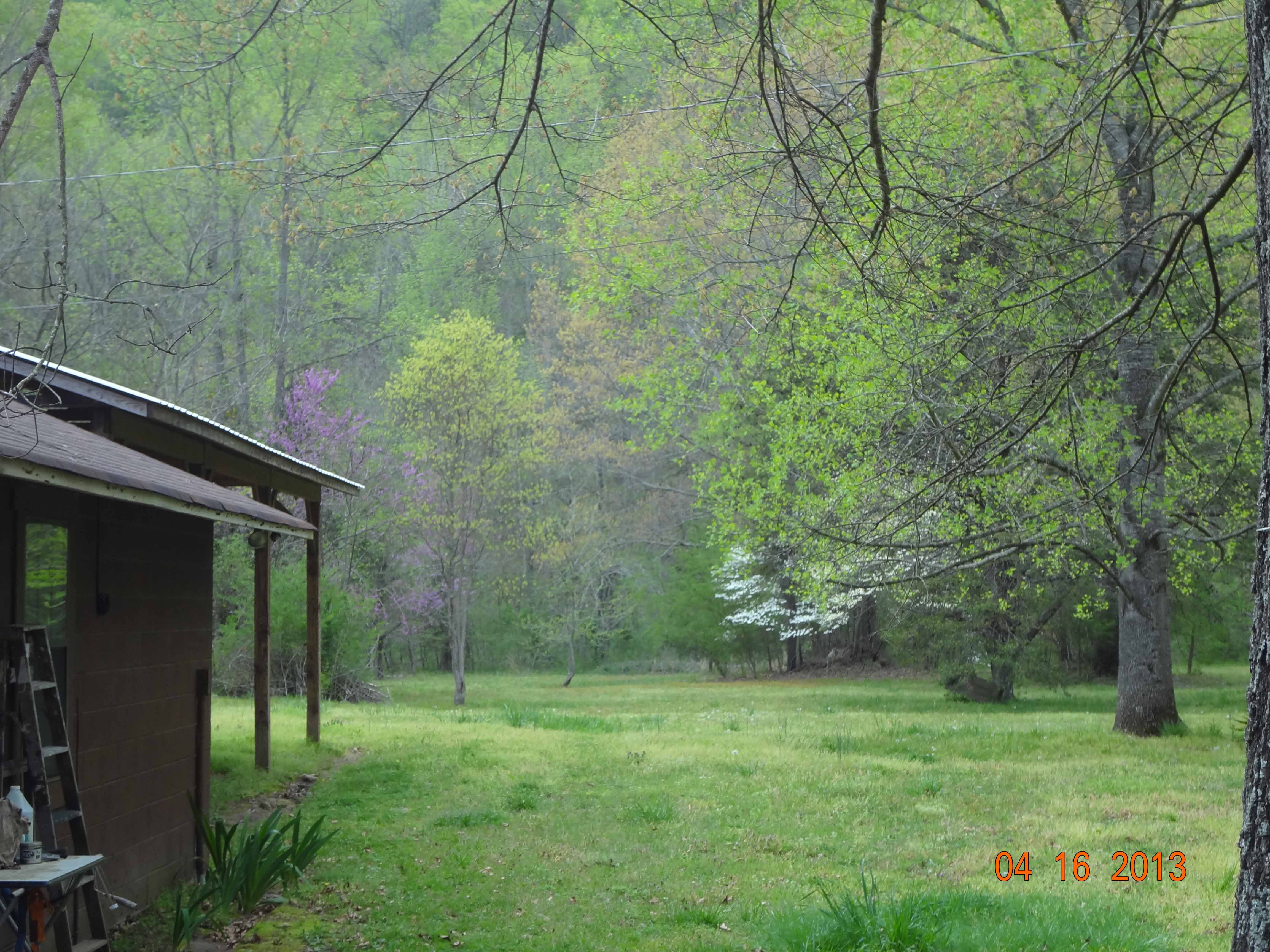

    A couple of weeks back I bought a Toro ZTM. The MX4250. It's the best purchase I've made in a long time. No back pain. No shoulder pain (I have a permanently torn rotator cuff). And so much faster than my JD 120. The pic will give you an idea of the kind of mowing I do so the ability to maneuver around "stuff" is very important to me. If you have a lot of mowing, get a ZTM.

    Well, I'm jealous.
    The mower sounds great, but that view....absolutely gorgeous!

      Chattanooga? I do not remember seeing that much flat land in one area! You'll like the ztr, but they do not much like slopes and hills. I don't know if the owners manual addresses water much, but some earlier ztrs that had water hose hook ups for a deck wash sys had transaxle problems with water being blown past the shaft seals, so careful how you wash it down.
