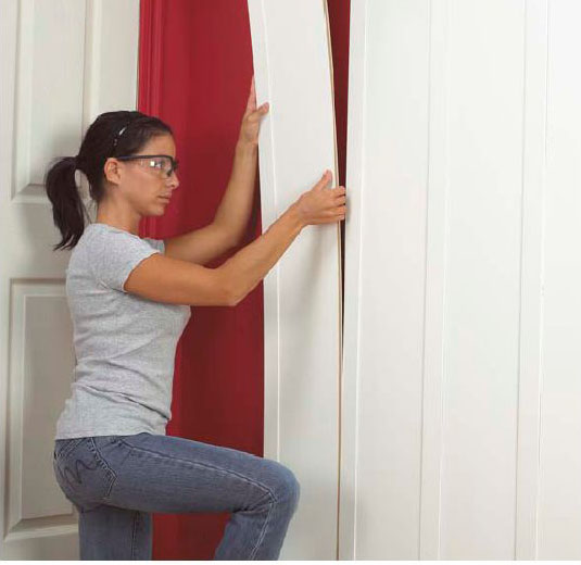

                Reading the descrpition and specifications it is a bit conflicting to the 5 1/2' x 8' wall panel in the header. Descrition shows 14 sq ft per carton and the specs list it as 8' long and .4558' (5.469") wide. The installation guide is for a plank type material.
                  Panels have the detail on one edge...

                      Not really as I'm only going to 34-36 in. in height which means I'll get 3 cuts per strip at 5 1/2 inches wide. A full size 4 x 8 ft sheet is $21 at the store to get that height I'll need to buy a lot more cost wise and have more scrap left over. Pappy was right tho it is as he described and not whats shown on the website(factually they have no sheet goods wider than4 ft),so even at this price its gonna be cheaper than buying sheet goods for me with less waste material at my determined height
                      16 1/2 x 5=82 1/2inches @34-36 inches in height@$16
                      vs
                      8ft sheet cut to 34-36 inches wide=96 inches@$21
                      So at this price I ordered 20 more as they had sold out but found some at 2 other stores, my manager and I saw eye to eye on the confusion on the description and he knocked the price in half again for the newly ordered stuff bringin it down to $1.60 a piece so I can finish the remainder of the short wall I'll be doing in the dining room and bath, looks better than the plywood panel IMO and hopefully goes up easy with the glue and nails. Either way they jacked the price back up, fotunately I got in on the deal before they shut it down

                        I generally don't like "MDF" anything. But, I'd have to see this, as the price sure beats other alternatives for wainscote. ("Bead-board" ply panels are more than twice that price around here.)
                        The last picture showing the young lady installing it, opens some ideas for solution to a troubled wall I have at the top of my stair case.
                        Thanks for the post,
