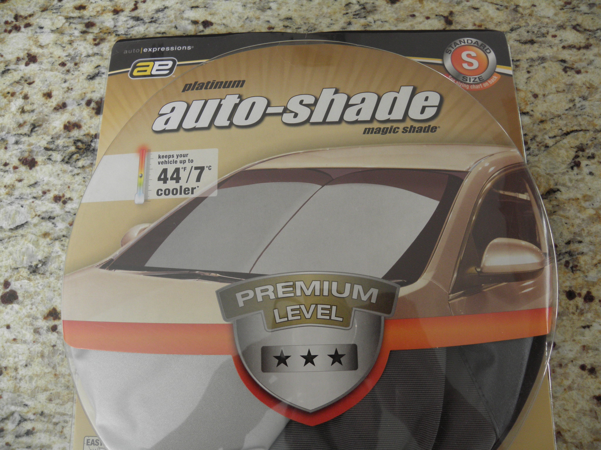

What's wrong with this?
    • 22106
    Auto shade packaging?
    Hmmm, looks like somebody slavishly followed the 5/9 + 32 formula (or whatever it is that I was supposed to have learned in the 10th grade, some 55 years ago!).
      • 22106
      right, when converting absolute temperatures you have the 32 degree offset.
      So if its 44 deg F outside, yes, it's 7 degrees C.
      But When comparing temperature DIFFERENCES, the offset drops out and only the 5/9 ratio applies. So lowering the temperature (a difference) 44 deg F is the same as lowering the temperature 24 deg C, not 7.
      Another case of knowing a little but not enough is hazardous.
      Maybe its a curse, but when I see numbers I want to try and make sense of them. This one rang my bell immediately.

        I get a little more than 24.4 C assuming 44 F is correct or 12.6 F assuming 7 C is correct.
          I'd bet on the second. A 44°F change seems a bit much.
          Bob
            I have the opposite curse: numbers make no sense to me. Ever. Even so, I could tell something was not right with the label.
              I agree, Bob.
              Richard
                • 22106
                44 degrees F is possible. a black dashboard in the sun under glass could probably easily reach 150F (in Texas in June) while being shaded could make that dashboard more like 106F...
                12.6 deg F is nothing.
                  I agree, but it might depend on the conditions. Any reduction even if it's 12° is better than no change.
