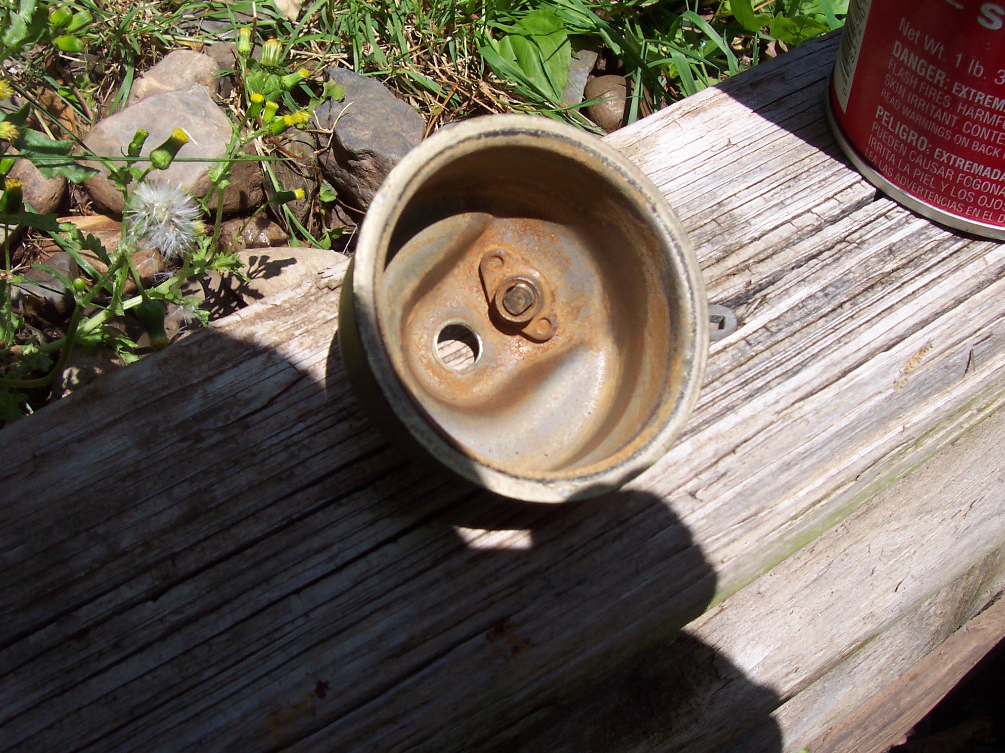

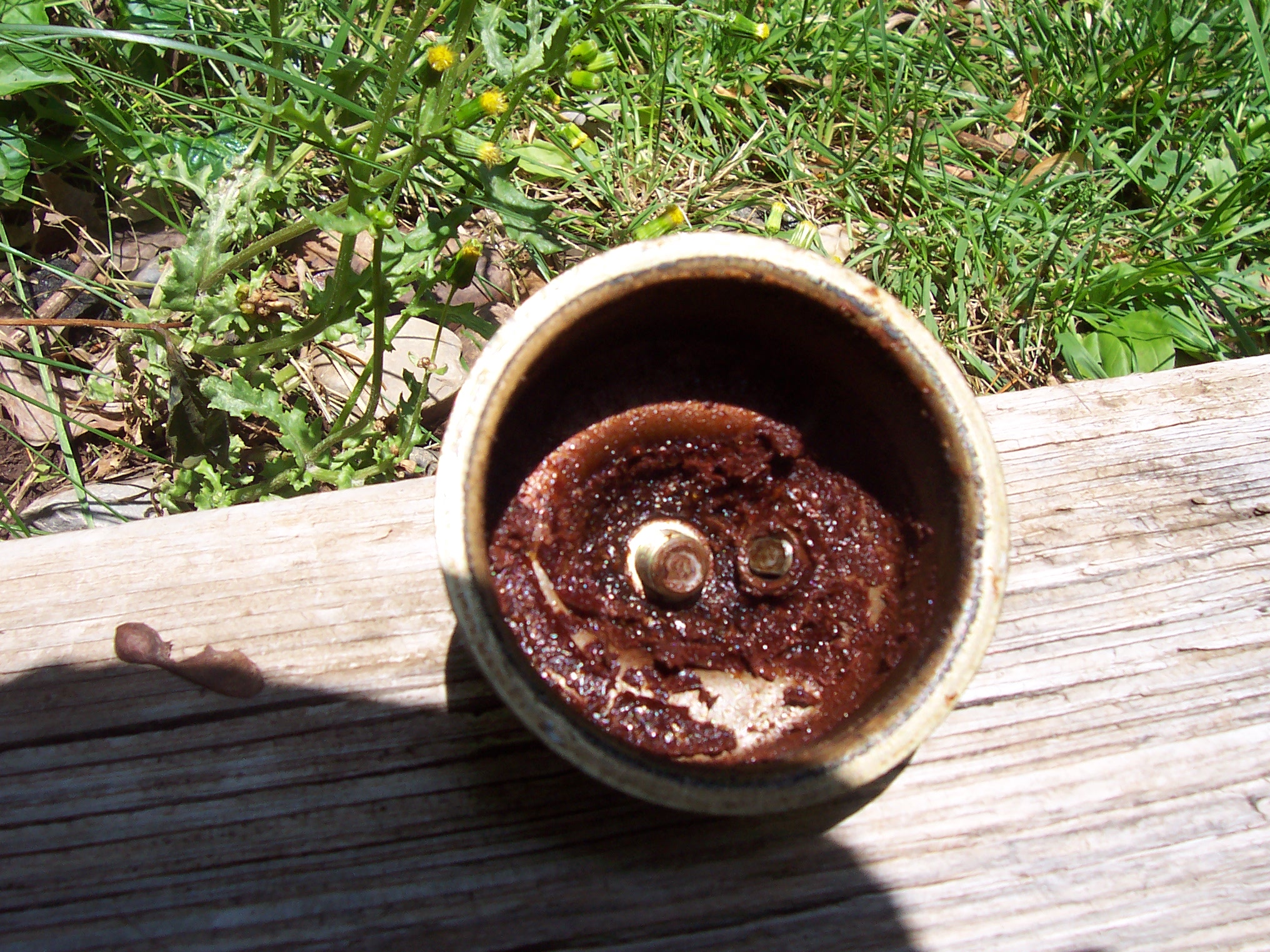

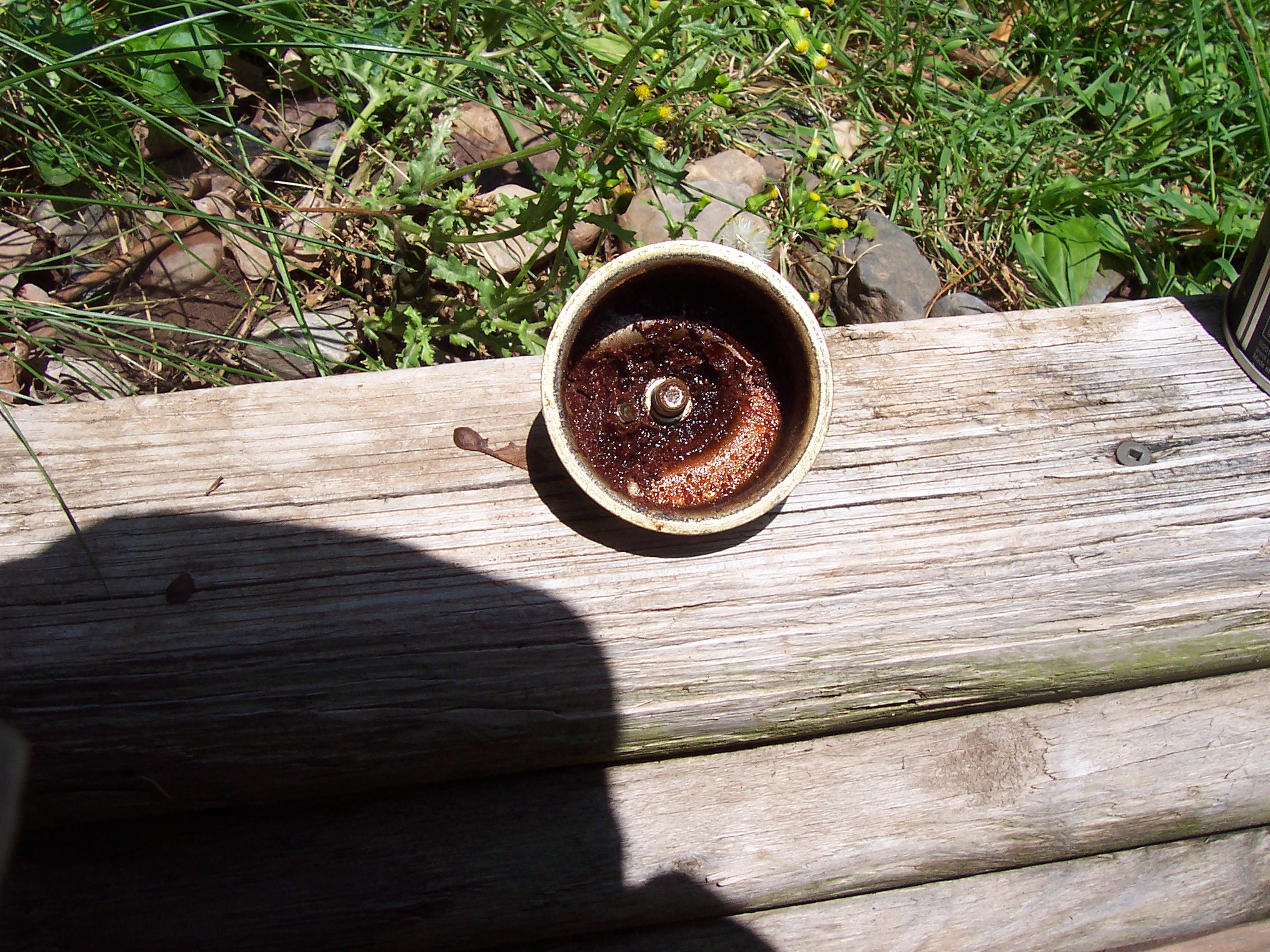

                        trying to post a few photos of ethanol results

                          Is that from using regular unleaded with ethonal? With a fuel filter?

                            #28
                            Ethanol without a 10 micron fuel filter, the ethanol cleaned the inside of the tank and it went through a regular fuel filter.
