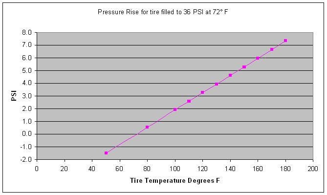

          Your numbers seem low. Pressures in an enclosed volume rise when the gas inside is heated - a fundamental law of physics of gasses. This means a heated tire will have more pressure than when it was filled at a lower temperature.
          In texas we get days where its 110F air temperature.
          Then the blacktop roads get to 140F surface temperture, in contact with your tire.
          If your tire is flexing continuously and scrubbing on the road because its footprint and sidewalls are flexing at high speeds then it will also rise maybe another 10-20F. This is why they give you hot and cold inflation values or just tell you to check inflation pressures when cold.
          Note that underinflated tires will flex a lot - this is what caused the Ford/Firestone problems - ford recommended too low a pressure for various reasons, the tires overheated more than most, and the tires were substandard for withstanding heat and flex damage causing failure.
          It's not inconceivable that a tire on a hot wide-open texas highway (which was in fact a high precentage of the Ford explorer tire blowout fatalities) that the tire temperature will reach 150F to 160F in my scenario above.
          I computed the temperature rise in a tire using Charles' Law:
          One case where the tire was filled at 50F and 32 PSI and the other for being filled at 72F and initially at 36 PSI.
          If you look at them there can be as much as 6-7 PSI rise over the initial fill pressure, when driven fast on a hot day on a blacktop highway when the tire gets to 160F.
          Note the pressure rise will decrease with initial fill pressure, and decrease with higher temperature at fill. I mention the fill temperature effect becuase its not improbable that you could fill your tires at 50F on a cool evening and a few months later be on a very hot day. Simply going from 50F to 72F on a tire initially at 32 PSI will raise the pressure by about 1.5 PSI.

                        hank you make a good point there, the cooling from the airflow probably helps keep it cooler. Still if the air temp was 105 and the road temp 105 then the tire would be 105, too.
                        if you look at my chart which is solely based on the temperature of the tire and its air, then you're looking at 2 PSI rise from 72 to 105. So that says what your are seeing is right. I think the hot cold temps listed on the door jambs differs by 2-3 PSI so that more or less agrees then. Setting the air at a colder temp than 72, you could have a larger rise at 105, of course which was one of my points.

                          The chart to me looks like a static test. Other factors (not based solely on the temp of the tire and its air), affect the inflation/deflation figures. For example, tire construction, type of materials, load, speed (friction/resistance). In a static test, it's entirely possible for two like sized tires from different manufacturers could respond differently to the same temperature variations.
