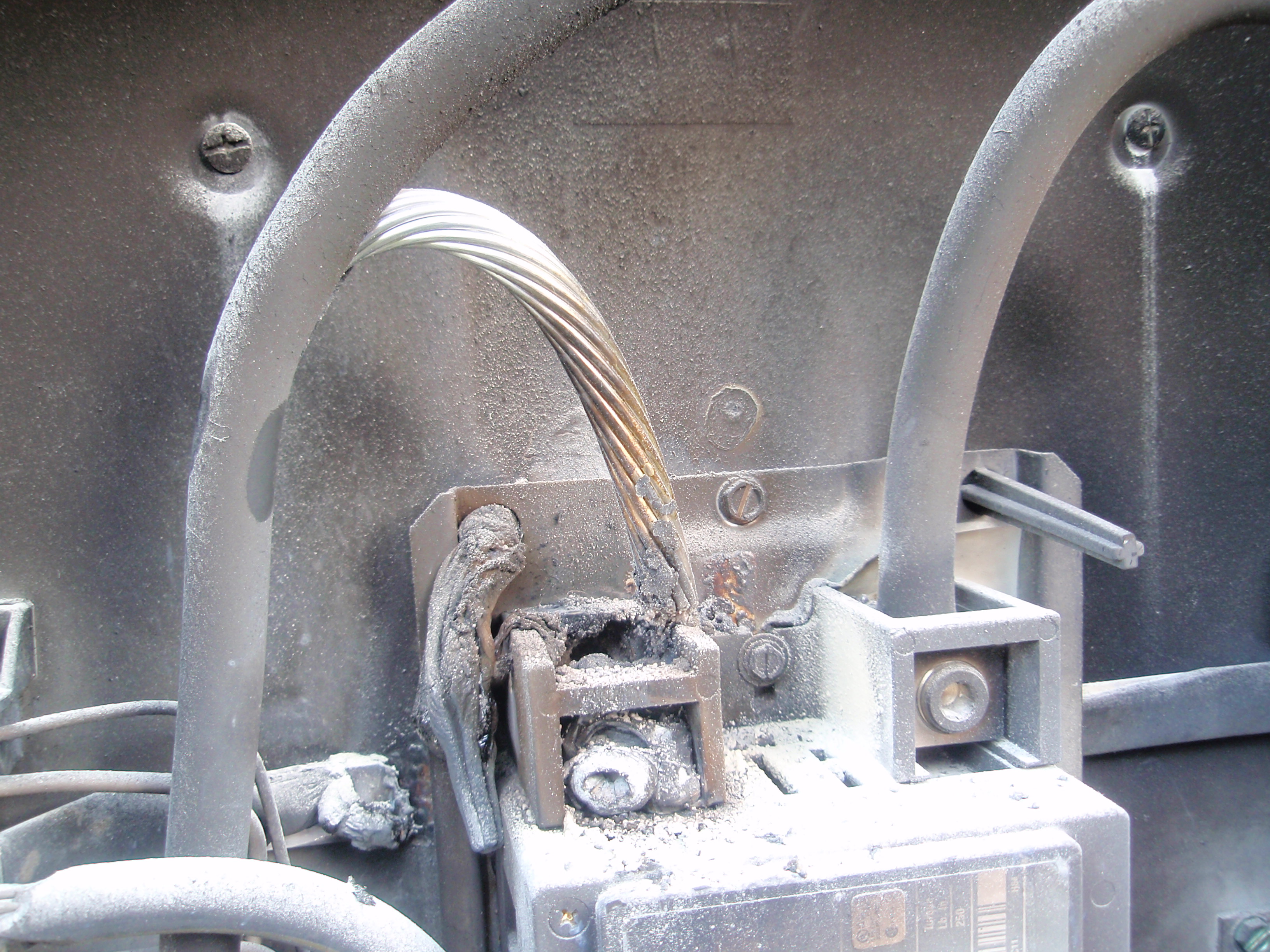

    I was helping my daughter pack Friday before the movers came Saturday morning. She asked me if she should bring the fire extinguisher I gave her and her hubby for Xmas or leave it with the old house they were to rent out. I said sure, its not to protect your renters but to protect you and your house.
    So on Saturday they moved and we went over in the afternoon. They had two A/Cs running (Upstairs and down stairs) and not much else besides a TV.
    The power went out and they were going to call the power copany I told them to check the breakers first. The main 150A breaker kicked out. They reset it and about an hour later it kicked again. I went to my house and brought the clamp on ammeter and took off the panel and the ACs were drawing about 20 and 10 Amps and the main feed was showing around 32 amps.
    I noticed the main wire into the main breaker was a bit discolored and said try again but you'd better call a electrician to look at it.
    We put the panel back on and closed the door, to close the door you have to bump it. When my SIL's father bumped the door shut there was a large arcing sound followed by sparks coming out the seams of the breaker box, sparks coming off the gound wire to the ground rod (like a fourth of July sparkler), followed by smoke and then flames and continued arcing noises. The power metere was spinning madly. When the flames came out about 6 inches from the top of the box, I told the SIL to call 911 and get the fire extinguisher which they had brought following my comments the night before,
    Finally the arcing stopped with a pop and the fire extinguisher put out the flames. I was worried something night be on fire in the walls but then the FD arrived they checked the inside walls with a thermal imager and said it was OK. We took the panel off and here's what it looked like (the white is the extiguisher chemicals). The tiny wires at the left are the 12 Ga branch wiring. The Big wires are the main breaker feed - the left one melted in two and peeled the insulation off. The FD called the power co who came out and disconnected and red tagged the meter.
    Having fire trucks with flashing lights and all outside your house is a good way to meet all the new neighbors. All in all an exciting day. After $2600 repairs they found the big screen LCD TV had been zapped, too.

    So what caused that to happen? Was the panel's feed not torqued down properly or something?

      Thank goodness for thermal imaging. What was the cause...loose connection?

        I wonder if the home inspector jostled something loose when he did his walk through. Doubt it but how is something ok one minute and not the next.

            I seriously doubt that the inspector would jostle the main feed line, since its hot and connected to the meter it can't be disconnected except by the utility company. He was covered by the report in which he specifically stated that the feed wire was aluminum and should be inspected for the Al-Cu gel they use to minimize oxidation and resulting fires. Hard to believe though why it happened after previous owners had used it for ten years, at probably higher current levels (they could have been baking in the oven, running appliances, etc), they were only at 20% of the breaker rated current.
            I'm almost sure that oxidation or loose connection contributed to the hot connector that was at the root of it. If you click on the pic you can see the allen screw that retain the left feed wire is melted and distorted (compare to the one on the right).
