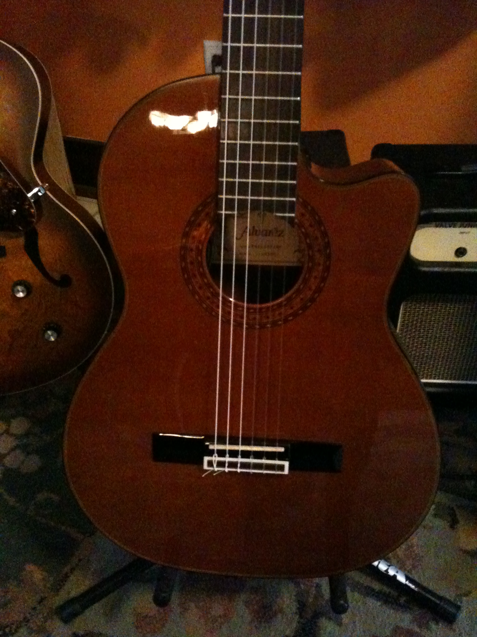

    Been busy lately with work and new fiancee, so haven't posted much lately!

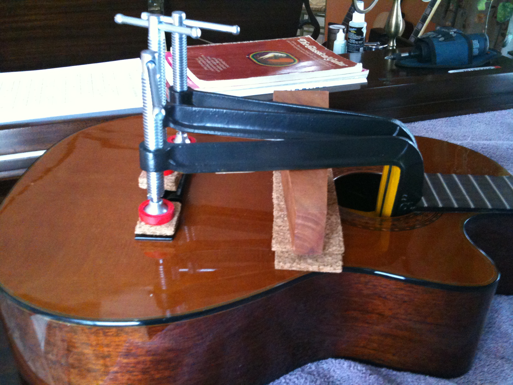

    However, I thought you might find this interesting. The bridge broke off my classical guitar due to very dry conditions this winter. I looked into getting it fixed by a professional, at a cost of $90-110.
    Then, being a cheapskate and enthusiastic DIYer, I decided to do it myself.

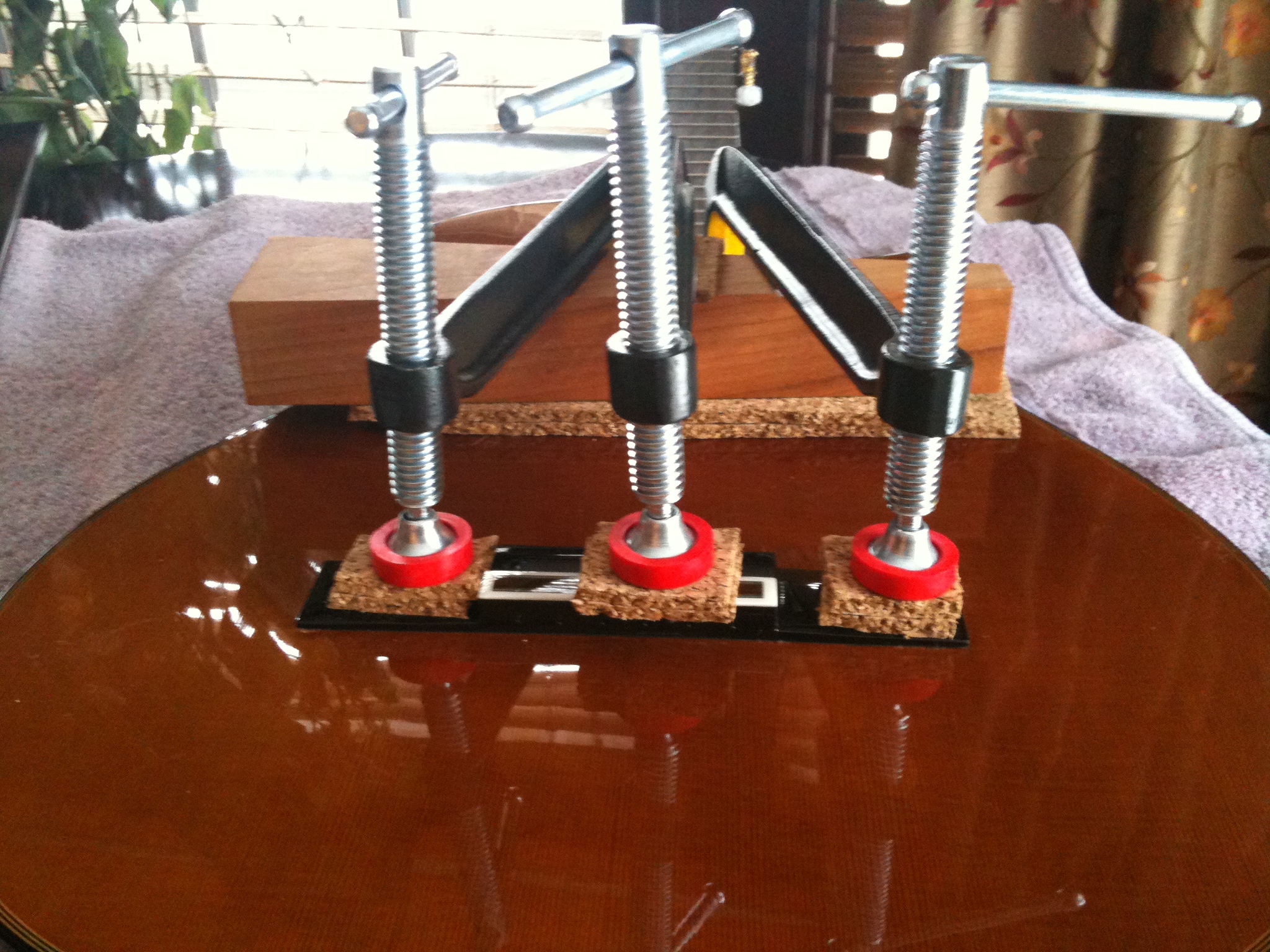

    There were no deep-throated clamps at the big-box stores or even at Midwest Woodworkers in Omaha (basically a Woodcraft). But at Harbor Freight--success! 8" throat clamps for $6.99 each!
    You can see before and after shots--so far 100% successful! I used Titebond 3 glue, by the way--recommended by a lot of luthiers for repairs of this type.

      Low humidity can play havoc on delicate string instruments. Do you keep your guitar in a case with a musical instrument humidifier? I like to use Dampits.
      Here's a tip. I like to use pieces of old hacksaw blades to make mini scrapers. These can be used to delicately clean off the old glue before regluing.
