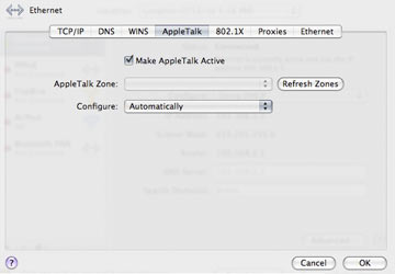

    Paul,
    Just got home from work, here's a quickie. Check to see that Apple Talk is active, you'll find that in system preferences-network-advanced. Sometimes, that kicks out (Microsoft demons come at night and screw up your mac).
    I'll send you some screen shots tomorrow, way too tired to start making screen grabs now.

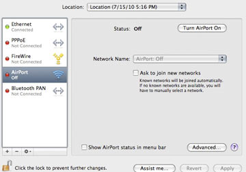

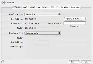

            What you never really clarified is
            1- How you're connected to the internet (you mentioned DSL (what bandwidth), you do realize that a DSL connection fractionalizes with more uses (your family) logging on. And although this probably isn't the problem, it is something to know.
            2- If you are using a wireless network, a) is it yours/ or are you piggy backing on to a neighbor's network. If it's your's, do you have that wireless network passworded (and hopefully firewalled)
            3- If you're hardwired is your Ethernet connection on your mac turned on.
            I'm attaching a screen shot of my network set-up, we use both wired and wireless here at home, we have 3 desktops and 2 laptops so I can use (if I choose to) either. I always connect via Eithternet as the thru-put is faster.
            Additionally, I have a cable connection, way faster than DSL, and no worries about slow-down when all of us (4) are connected at once.
            My IP, the cable network assigns an address for me which is different everytime I log on (dynamic) addressing, while most DSL IPs require you to manually put in an address (which they supply you with at sign up) and that set of numbers cannot be changed ever.
            Glad to know you up and running, but if you ever run into this or any other Mac based problem and there's an Apple store near you, you can bring your machine to what Apple calls "the genius bar" and they will look at it and help you out for free, no matter how long your machine is out of warranty, free only if you dont have a hardware problem that needs replacement.
            You can make a reservation from home, even using a PC, apple.com. Ding a store near you and get into the genius bar or concierge screen and pick a day and time.
            Let me know what happens

              Most DSLs give DHCP - dynamic IP port addressing. It can be different when you log on. There's a reservation time - if you log back within that time then you get the same IP because they hold it for you (or at least someone with the same MAC address and these are supposed to be unique to the ethernet hardware you have) and you can continue a broken connection after that time it can be reassigned to someone else. Homes and offices have long reservation times but busy places like public wifi with a lot of user turnover use short reservation times so they don't run out of addresses.
