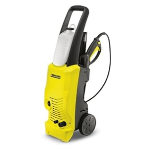

    I'm looking at this pressure washer from Amazon.
    What I need is something to wash the dirt and not the paint of of the house and to get the winter mildew and moss of of the fence and deck. I know that a gas unit will do a better and faster job but I think they are too much machine for what I want to do.
    Does anyone have experience with this washer or perhaps like a similar priced unit better?

    I have a 1200 psi 1.3 gpm Karcher that I use for car and house wash. Works great. I have a problem with mildew stains on the north side which it easily removes. Before that I had a Campbell Hausfield that only lasted 2 years. That price for a re-furb seems a bit high. These things are rugged but can be easily abused.

          I have an Aldi KingCraft electric pressure washer and a Karcher unit that I bought at Big Lots that is similar to the one you are looking at and neither of them work any more. I believe the problem is with the built-in GFCI units which I think have failed. I have a friend who replaced the GFCI unit and his pressure washer started working again.

                    I have the smaller version of that unit and it works great for most jobs. The turbo nozzle is a real time saver. I dont run chemicals through mine, I use a pump up sprayer. Unless you flush the unit well, the chemicals can corrode quickly ruining your unit.

                      A couple of good heads-up were mentioned.
                      1. Don't store in freezing temps without clearing of water.
                      2. Be careful of the chemicals you use, some can shorten the life of the pump. A hose end sprayer attachment gives you a better option on what you can use.
                      3. After several uses spray a lube into the in-put with the unit running and the out-put hose disconnected. Someone might correct me on this but I think WD40 is acceptable.
                      4. If you use hot water don't exceed 110 degrees. Manufacturer may set this at a different level.
                      5. I think most units now come with a drop pressure sensor. Which means they run when you pull the trigger and shut off when it's released. My CH unit didn't have this feature, meaning it ran as long as the switch was on. I believe that greatly contributed to it's early demise.
                      6. The GFI on the CH unit also failed. I replaced it with a common plug because all my outside receptacles were GFI.

                        Having it plugged into a GFCI protected outlet I wonder about the need for one on the washer. The one I borrowed the GFCI was very tempermental and a simple bump would cause it to trip off.

                        I was wondering about that, soap caustic enough to really clean may do a number on the plastic inside. They sell soap packs I wonder if there is anything special about them. I was also thinking of adding something to get rid of the spiders to the soap tank but thinking about it more that may be a bit dangerous as the water from washing gets all over everything. I should probably stick to the Hudson Sprayer for that.
