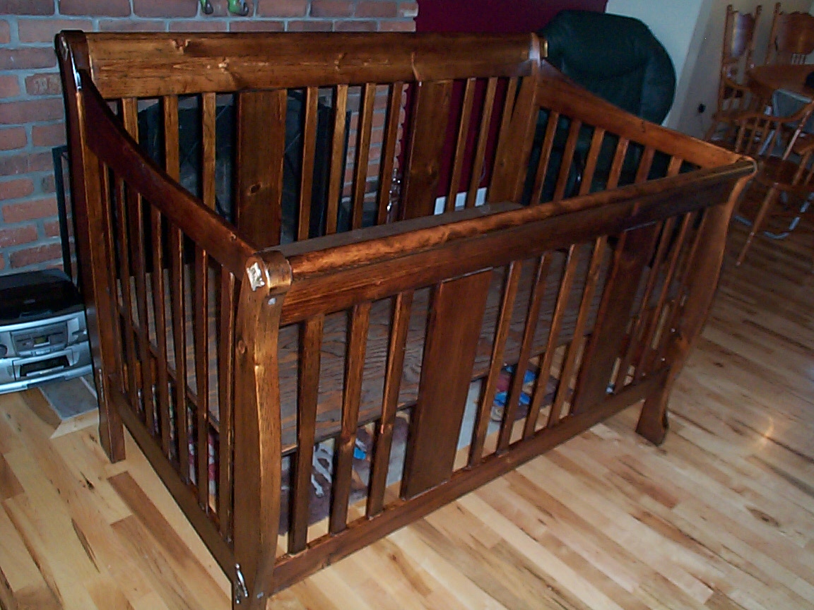

                  I built the Rockler 3 in 1 and it does have a drop side
                  You can see my result here
                  I'm aware of the hoopla about drop sides at present in the news BUT ... I believe a lot of this is parents not being as careful as they might be ... regardless I found the plans to be well written ... I did modify to fit my design ideas and am looking forward now to the time when the toddler bed is required as the extra pieces are taking up storage in the storage building ...
                  PM me if you have questions ...
