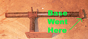

                        Alex,
                        Here is what I found in the garage. It hasn't been used in quite a few years, but it just needs a little TLC. Any questions?
                        The base is gone, as you can see. A thick piece of MDF should work fine.

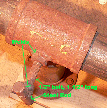

                        The next pic shows an elbow, with 2 of the threads removed so it can slide up and down for adjustment.
                        The following pic is just a small bolt that will hold the flange in position, once set.

                          I should have mentioned, the pipe used is 2" black pipe. The length is 36", and the short piece of pipe is 7 1/2" long. The board for mounting the camera is 7"X11". It was used for both a 35mm camera and a medium format.
