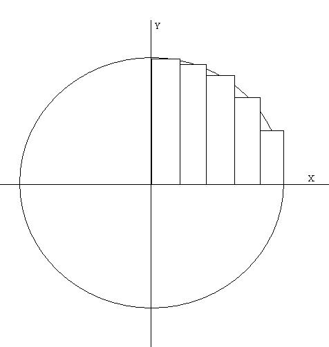

              Here's another way that can be done entirely with a computer rather than physical measurements. Called numerical integration.
              A circle can be defined as x^2 + y^2 = R^2 where R is a constant, lets use 1. Then the area is Pi x R x R = Pi.
              Its all symmetrical so we can use the area of half the circle (y>=0) and double the result, or 1/4 the circle (Y>0 abd X>0) and quadruple the result for simplicity and reduction of calculations.
              So the height of the half circle at any point X is Y=SQRT(R^2-X^2) or
              since we are using R=1, Y=SQRT(1-x^2).
              if we approximate the quarter circle as a bunch of columns equal to the height of the circle at the center point of the column then the area of the quarter circle equals the sum of the area of the columns.
              as you decrease the width and use more columns the error in area (the small triangular pieces in then upper corners) becomes smaller and smaller and the approximation becomes very close.
              So sweep the value of X from 0 to R, in N steps. Assuming N is 5, Then the centers of the columns (for R=1) will be at .1, .3, .5, .7, and .9.
              For N steps the first column center will be at R/(2*N) and stepped R/N to the next column center.
              if you use N=10 you'll probably get an answer for Pi between 3.14 and 3.3 but as you increase N you can see the sum converging upon 3.14/4. With a N=1 million, your answer will probably be good to 4 or 5 digits. (your answer is the sum of the column areas which is equal to Pi x R^2 /4 which will be Pi/4 since we picked R=1.). As you increase N you can literally see the answer converge upon Pi/4 as the little error pieces get smaller and less significant. Remember each column area will be
              R/N x Y
              or
              R/N x SQRT(1-X^2)
              where Y = SQRT(1-X^2) which is the height of the center of the column.
              There are refinements, such as calculating the area of the trapezoid made by the two sides of the column rather than the center height of a simple column. What I have described is Simpson's Rule midpoint and trapezoidal methods. (Man, had to look that up, haven't used it since 1st year college). You can read more about it in Wikipedia.
              You can program with with a simple BASIC program or do it on a Excel Spreadsheet. This is a great computer excercise and involves no trigonometry functions and will give an exceedingly good value for Pi as you extend N, much better than you can do with a cup of water.
              Good luck.

                      • 22060
                      I did a quickie BASIC program in full double precision 64-bit floating point math for simpson's rule and I got these results (always on the high side because of the geometry):
                      N = 1, 10% error
                      N = 10 .3% error
                      N=100 109 ppm (parts per million e.g. .000109)
                      N=1000 3 ppm
                      N=10000 .1 PPM
                      N=100000 .003 ppm
                      N=1000000 .0001 ppm, e.g. computed pi = 3.141592653934358 good to about 11 decimal places
                      a million steps only takes about 44 seconds on a 7-year old laptop computer with QuickBasic

                            And while as a math guy your formulae appealed to me, Loring, your diagram helped her more so : she agrees we could draw many of these rectangular boxes and if evenly sized and numbered, we could average the heights of the smallest and largest : so it helps in actual measurement too! (Hope to do this tomorrow).

                              I could agree that using the Simpson rule and actual physical columns as rectangles could work instead of computational integration...or demonstrate the closure of the computational integration as a first step.
                              As I discussed above, with only ten columns you should have the error down to .3% (or about 2 good decimal digits of Pi) which is actually fantastic. A 10 inch radius circle with 1" wide columns should yield fantastic results with 1/8" or so resoution on the column heights. - you could do N =1, 5 and 10 easily and show the convergence.
