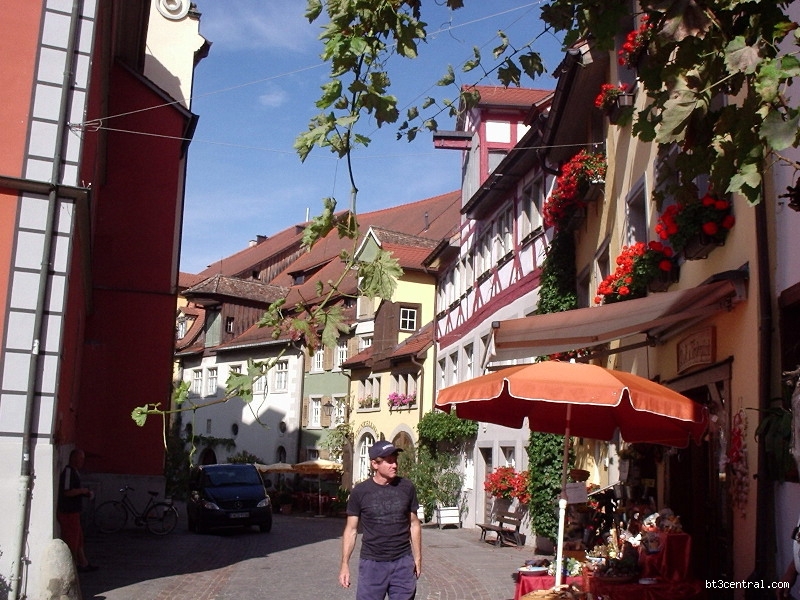

      I noticed a lot of hoist arrangements at the town of Meersburg, Germany, while on vacation this summer. Many of them seem to have incorporated the ability to move the block along the beam at the upper level, as suggested by Bill. Note the designs incorporating covers, too.
