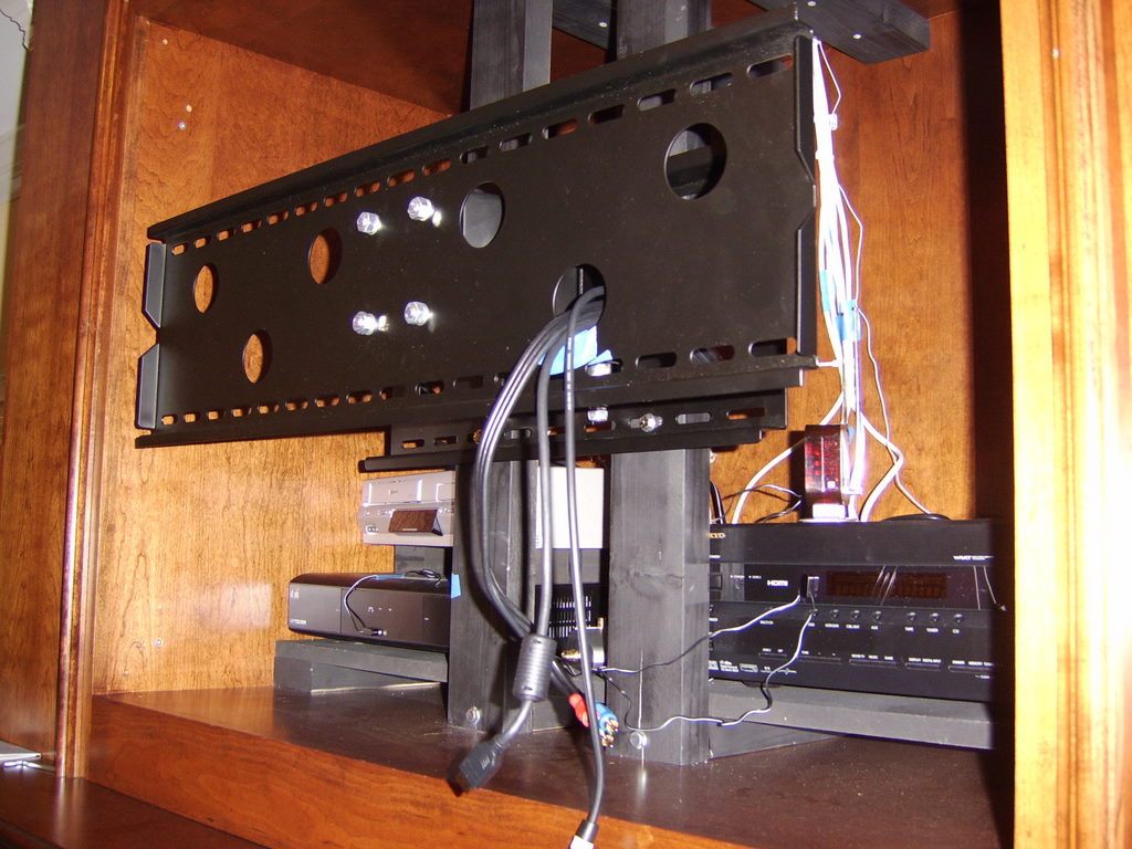

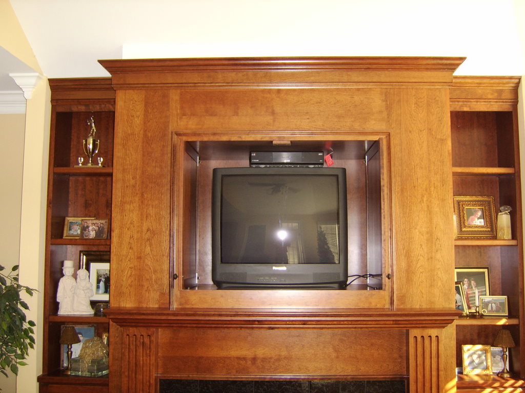

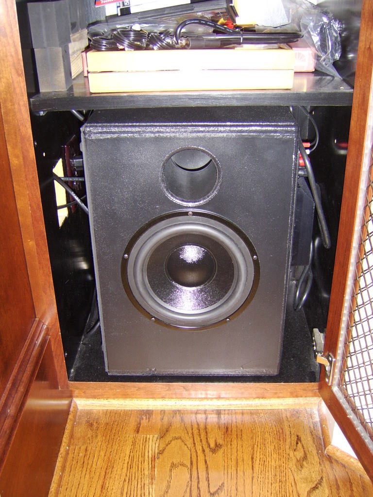

      And since it's a woodworking forum, I can use this thread to show off the little bit of woodworking I did for my parents setup. I converted their custom cabinetry built for a 35" CRT tv over the fireplace to using a 46" widescreen LCD while adding surround sound. To keep it on a budget and totally custom fit it to their cabinetry, I also designed and built the subwoofer. Speakers are mounted to the ceiling, one is just visible in the top right corner of the "after" photo.
      -Brent
