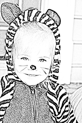

      You can get pretty close using the GIMP (www.gimp.org) using the Photocopy filter.
      Oh, and the GIMP is free and work on must about any operating system. And did I mention it's free?
      I'll play around with it a bit and see if I can't get anything a little more coloring book like.

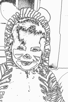

          Here's another one I did using the GIMP by first converting it to 10 indexed colors, then back to RGB, then adjusting the levels to increase the contrast, then converting to 2 indexed colors. It's a little closer.
          BTW, did I mention that the GIMP is free?

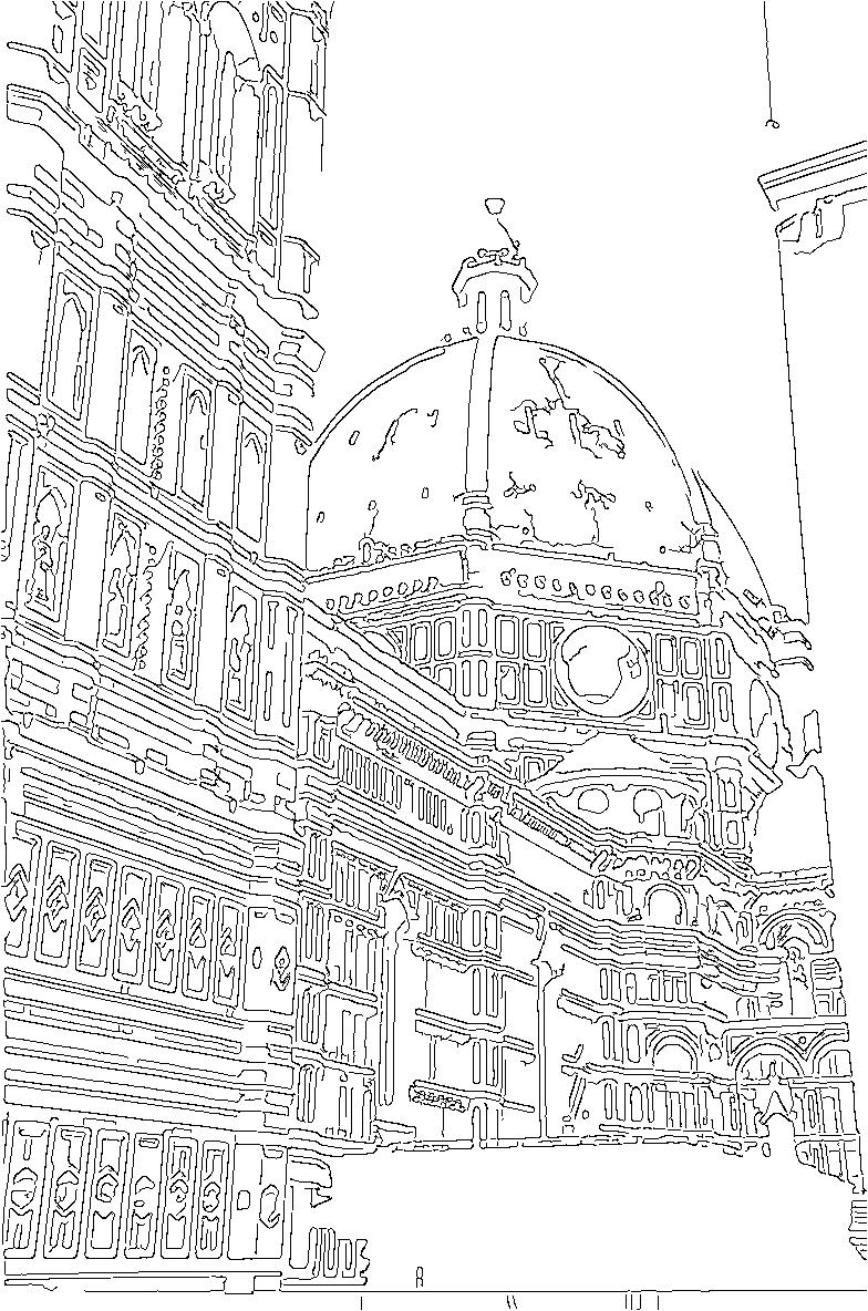

              Here's another one. I use PhotoS to turn pictures like the first one into the second one for transferring to piece of wood and then using dremel to etch it.
