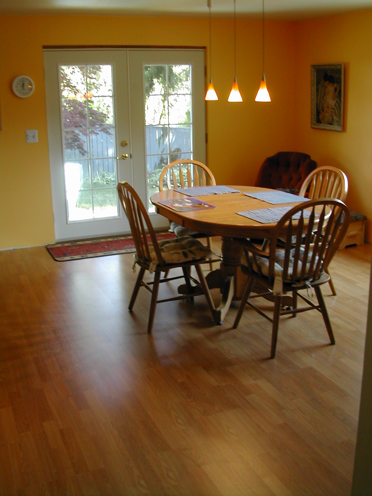

                              I did 60% of our house in glueless laminate flooring. It was easy to install and still looks great 6 years later despite the abuse from my 2 and 9 year old boys. I don't think hardwoods would have held up as well. I was so impressed with it's durability, that's when I got started making benchtops out of it. (Great for jigs too!) We chose Quick-Step as well because it rated very well in quality while being easier on the budget compared to Pergo. Pergo spends a TON of money on marketing.
                              6 years later he only downside is that we have a couple of spots where water was left on the floor overnight and it seeped into the joints and swelled up a little.
                              Otherwise I would do it again without hesitation. Here is a pic of one room in the house.
