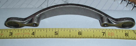

            • C-Man 22114
            Basically what Loren said. In addition to the foggy image, the tape is not aligned with a good reference point in the center of the left lug. Aligning the tape with the center of the handle, IMHO, is not the correct way to make this measurement with a tape. I would put the 1" line on the center of the left lug and make the measurement if I was forced to use a tape measure.
            That being said, its 4 31/64" as best I can tell from the photo

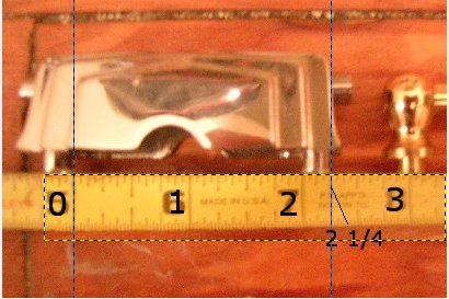

              still looks like 2.25 to me... Here's why: (I overlaid a different part of the measure because the divisions were clearer.)

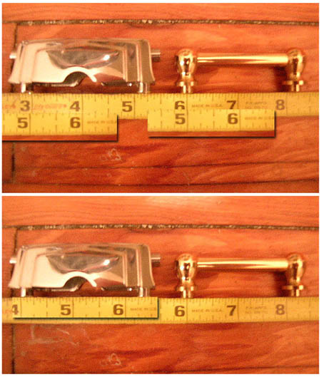

                Taking this a little further.......
                Well, I can say first that there are some strange shadows in this image. The shadows on the right go to the left and on the left there seems to be no clear shadows at all. There must be several lights involved. The handle on the left clearly indicates that the angle of view is skewed to the left, at least for the left side of the image.
                It looks as though the picture was taked through the bottom of a coke bottle!
                Additionally;
                I used Photoshop to cut out the center section of the tape measure. I then overlaped it onto the left side and the right side, applying drop shadows to be able to distinguish the cut sections. I agree with Uncle C, the tape cannot be stretched. What has happen is that the image has caused the tape to appear progressively shorter as you move away from center in either direction. This not only makes the tape measure a false reference but adds to the blur in the image at the far left and far right.
                Using the center section of the tape and moving it to the left, the C-C seems to be 2-1/4".
                But, if you agree that the tape measure gets shorter as it goes from center to the left, then the handle would be effected the same way.
                So, the only true reference is the tape measure as pictured. Since as I stated before the image is so blurred, the 'best guess' would be 2-3/16". But, with this image I cannot be sure that the left side of the far left screw barrel is indeed sitting at the 2-3/4" mark on the tape. The blurred image, the curved nature of the barrel and the skewed angle makes that determination impossible.
                Yes, I know how to read a tape measure. And I also know how to take a good picture.

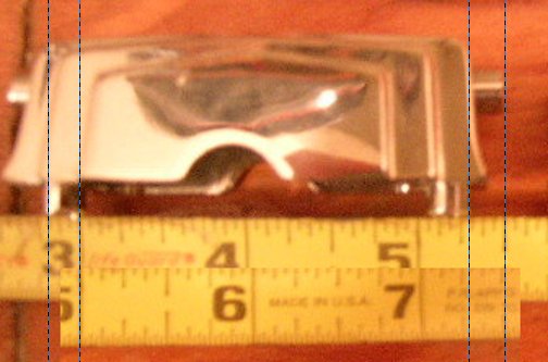

                • Alex Franke
                  • Feb 2007
                  • 2641
                  • Chapel Hill, NC
                  #23
                  Wow. Nice work!
                  I almost threw in the towel but then I thought twice. (I gotta stop doing that!)
                  So I fired up the Gimp again and here's what I got... (Click to enlarge)
                  The measure from 5-6 is clearly longer than from 3-4), but at 2 inches it's a little better and at 2.5 -- the fourth blue line, and closer to the overall length to be measured -- its even closer to a match. (On the top of the tape, which is cut off because it's not perfectly horizontal, the line shifts to the right another pixel because of the curve of the tape.)
                  So from the second blue line, travel a hair less than a 1/16 to the right and you get the right edge of the barrel. Then skip down to the third blue line on the other side, which is a hair less than 5/16 past the 5. 5 5/16 - 3 1/16 is 2.25.
                  BTW, the first blue line is where I would put the left side of the barrel because the camera lens is more to the right of this image. My gut tells me that bright whites tend to radiate and make make something look a tad bigger in an image, and the barrel might be a tad higher than the tape measure. So that's 3/6 in from of the 3. On the right, the left side of the barrel seems to be at 5 1/16. Add them up and you get 2.25 again.
                  So what am I missing? Is it the GIMP? (I just knew that I'd pay for this free software in some way or another! :lol

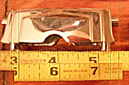

                    #24
                    Here's another image that's artificially sharpened.
