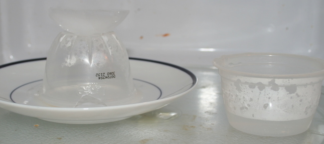

        Okay, here's what I did.
        I had to bring a power tool into it somehow, so I got a little plastic cup from a fruit snack and drilled a hole in the bottom so the melted water could drain away. My thought was that any water would heat up and I didn't want that affecting the ice.
        I took out two ice cubes. One in a bowl on the counter, and the other as shown. 30 seconds on high and there was no sign of any melting, but the (microwave-safe) plate was getting warm. Another 30 seconds and still no sign of melting.
        That's when I put the other cup with some cold tap water in microwave with it. 30 more seconds and there was one drop of water that came off the ice but hadn't even fallen through the hole. The other cup of water was already hot. and the interior of the oven was getting hotter.
        30 more seconds and the water was too hot to touch (the picture above), and the ice cube had melted only a bit more, and only pitted at the bottom -- where it was in contact with the water. The rest was wet but not significantly melted. By that time the inside of the oven was very warm -- so was the plate and even the plastic cup that the ice was on.
        At that time the ice cube on the counter was a little glassy, too. But not quite as glassy as the one in the microwave.
        So I'd have to say that microwave ovens aren't very good at melting ice... or maybe my experiment was faulty. Dunno. Need to talk to a physicist again, I guess. :lol:

          You're forgetting about the heat of fusion, that's a lot of extra energy...
          To raise a kilogram of water from 10 degrees to 30 degrees takes 20 kilocalories.
          To raise a kilogram of water from 0 degrees to 20 degrees (same temperature change) takes 100 kilocalories.
          This is the same reason (well, heat of vaporization rather than heat of fusion) why it's fairly quick to get your water boiling in the microwave, but takes a long time for it to all boil off, that extra phase change requires lots of extra energy.
          The microwave excites the water molecules because the molecule itself is polar, not because they are free to move around in a liquid.

              kristofoer is right. If you remember your high school chemistry or natural science there's a heat of conversion. When you heat ice you remove energy and the temperture drops from below freezing to freezing gradually and then stays at freezing until the heat of conversion is totally removed. The it proceeds to increase temperature again.
              Your cube was colder than freezing. When you heated it, the mircowaves heat it evenly throughout and it stays frozen until the whole cube reaches freezing then it melts.
              When you heat a cube in a pot or a hot surface, the water at the point of contact melts rapidly but not the cube above... this is due to the temperature gradient.
              That's why microwaves are good for reheating, they warm the whole thing evenly.
              Alex, it always takes 1 calorie of energy to raise one gram of water 1 degree C at 1 atmosphere of pressure and at any temperature. The exceptions are, to go from 0 to +1 C (actually that just to go past 0) and to go from 100 to 101°C (actually its just to go past 100). Each of those steps takes a very specific amount of energy to change phase. 80 calories and 540 calories, respectively.
              So since your ice cubes are originally at probably -5C and you want to heat them to liquid water at Room temperature (25C), it would take 85 units of energy just to bring them to melting point, then another 75 to bring it to room temperature. It would seem like it was ice for a very long time.
