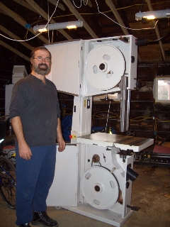

                            Postmortem and proof
                            The deed is done! I wound up renting one of the 6x9 U-Haul trailers with the long ramp. Not too bad getting the beast in (it has the mobility kit), getting it back out was a little more nerve wracking. It's now in my garage, asleep, waiting for the wonders of electricity to come to the new shop.
                            Hopefully the images uploaded correctly.
                            I'll post a follow on once I'm able to make some sawdust with it.
                            To do is to be.
                              That looks sweet!
