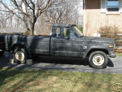

                    I'm assuming she looks like this
                    -Paul
                              I would love to get a new Gladiator. I like Wranglers and that one has a deisel engine in it. but mine looks more like this (the first pic is what she'll look like when I'm done. except Renegade Orange on the bottom. Straight from the 1970 Jeep brochure)
                              Truth to tell, I'm so tired of the primer grey that I'm thinking of doing a quick paintjob with farm equipment paint until I get around to all the bodywork (fixing all the rust). Gloss white for the top and Allis Chalmers Orange for the bottom
