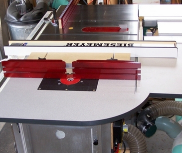

            I read that several of you are making your own split fence system, some even with dust collection capabilities, for use with the BT3 router table. I would like to make one myself. Do you guys have plans or reference pics that you could share here? Thanks!

                  I'd like to echo the request to see some plans for a good split fence that can be used on the BT3K or Craftsman 21829 and provides efficient dust collection. I made a solid one out of MDF, with fixed openings, but it is less than optimal.
                  Is anyone willing to share their plans?
                    Here is my split fence. The White fence section has a piece of melamine laminated to it. It is an offset fence for router edge jointing. I never got around to adding dust collection to the rip fence. I will one day.
                    Front:
                    Rear:
