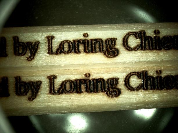

    Here's a picture of some 1/8" high lettering I did on the sides of a chopstick (there's two together before being broken apart.)
    Click image for larger version  Name:	 Views:	1 Size:	45.1 KB ID:	829204

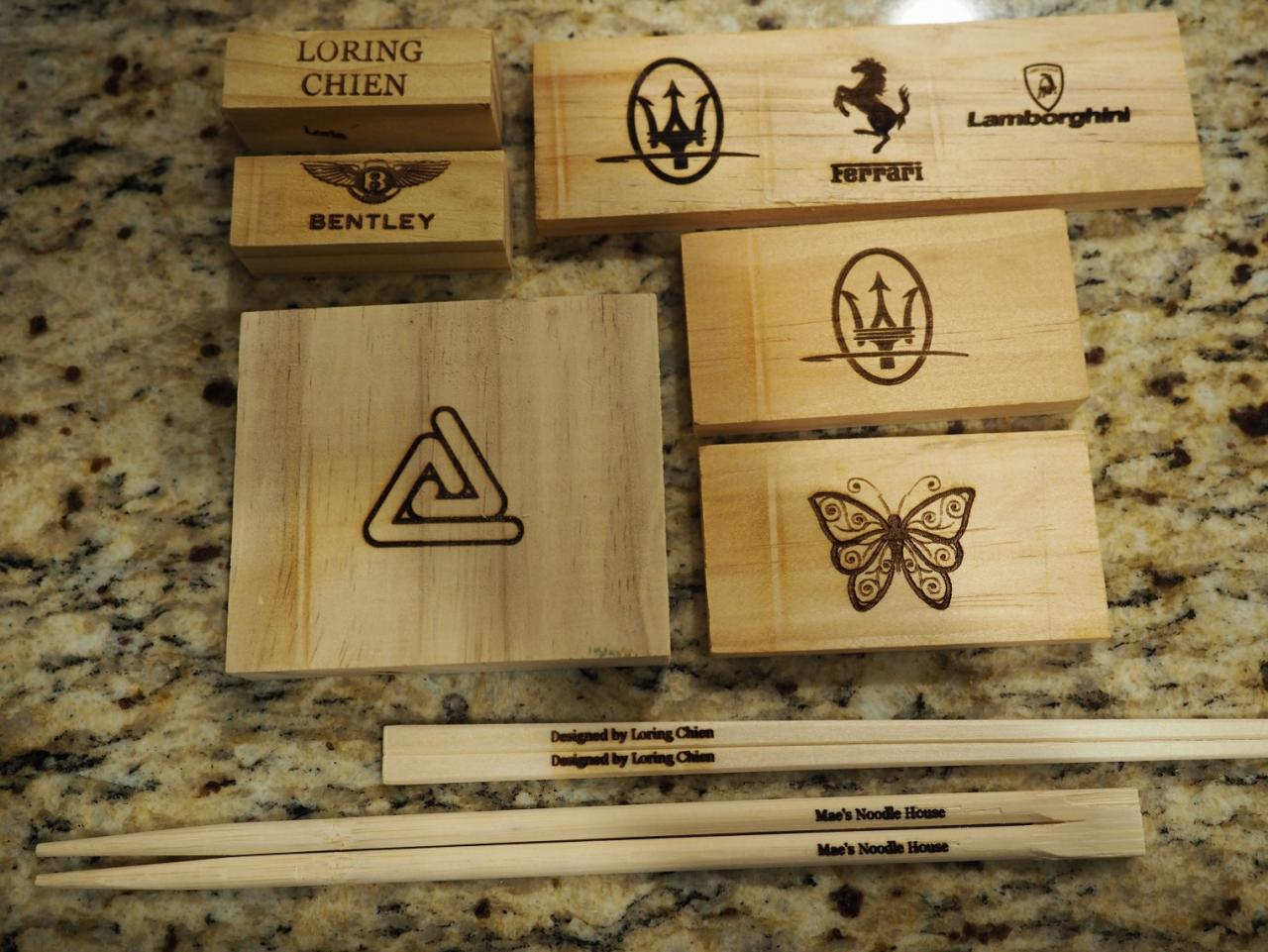

    Another picture all the scraps of wood I've been engraving.
    Click image for larger version  Name:	 Views:	1 Size:	161.5 KB ID:	829205

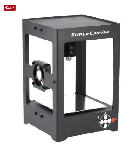

    and a picture of the engraver.
    Click image for larger version  Name:	 Views:	1 Size:	46.3 KB ID:	829206
    It's a 1000 mW unit that does about a 1.25 x 1.25" area, using 512 x 512 pixel image map. The stage is actually about 4"x4"

    Cutting pine puts a lot of resin in the smoke, it coats the wood, and leaves marks. The fan pulls it to the left and you can see some of the samples where the rubber band hold down left a unmarked line.Need more powerful fan and maybe a filter. Don't use it in the house, I think.

    Images take a few minutes. And you need to do some experimentation to determine the "exposure" time. Softwoods take only about 20 ms, hardwoods more like 60-70 ms. I tried a piece of stone tile at 150 ms and it wouldn't even mark it.

    That looks very good! I have considered one for pens, but am concerned that it is not quite up to the resolution that I would like. Your chopsticks give a good hint as to how a name would look on a pen but I would need about twice the resolution before I start engraving them. Did you try light passes to clean up with some fine sandpaper? Just curious.

      What is the actual size of the machine?
      i haven't noticed hold downs on the lasers I've seen, they just place the item on the bed where they want it.
      is the bottom, or stage area removable so you could set it on a larger piece of wood........ maybe the bottom of a tiny table top?

        8" high by 5-3/4" square.
        The laser moves X-direction, the table moves Y-direction. I tried laying a small piece on the table just using gravity and it slowly slid to one side as the table moved slowly northward.(the Laser o moves fastest because it does X-moves most often.
        Software still seems a bit obtuse. Drag and drop image files to the preview area. Limited to 512 x 512 pix resolution for engraving but it reduces or enlarges images automatically to fit.I have imported several files already. No gray scale though.
        I'm considering if its worth the trouble to make a hold down jig. The tray is 4x4 roughly, since it moves north-south only you can make an overlay 4" wide and maybe 6-7 inches long so it sticks out. Route a couple of t-slot in it and then laser some lines on it for line up. A few bent pieces of sheet metal and the t-tracks can make hold downs. It doesn't need to be real strong.
        With the open sides you can engrave oversized long pieces hanging over the table N-S or E-W if you are careful. That's how I did the chopsticks and that 3 in one engraving. Just can't put aworkpiece that's both long and wide on it.
        Now the next step up would be a model with a large aluminum frame base and a laser carrier that moves both N-S and E-W, then the workpiece just lays there and doesn't move at all.

            Loring, sounds just like the little NEJE I bought last year and posted about. I use my DC to pull the smoke away and keep it cool. Also, make sure you are using a 2A power supply, as it seems to need the power to prevent "hanging". Mine has a manual focus for the laser - assume yours has the same? This means I can dial in on the "resolution" Hank is describing.

              Can the bottom of the engraver be removed so it can set on a larger piece of wood and burn in something?

                The bottom cannot be removed on my unit, and likely Loring's as well, since the laser diode at the top only moves in one axis (x), and the platen at the bottom moves in the perpendicular axis (y). The laser moves back and forth, and the platen advances the work like an old dot-matrix printer carriage.

                  Bill is right, the upper laser carrier moves right-left and the bottom platen moves north-south so there's a mechanism in the bottom.

                    I didn't catch the movement of the bottom..... there goes that idea.
                    Some of the laser engravers I've seen in operation, I don't believe the diode unit actually moved x/y. It looked like the laser beam was being moved by mirrors. The cnc lasers used for cutting did move x/y.
