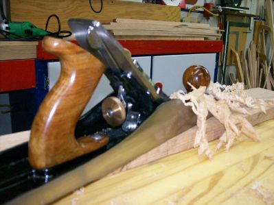

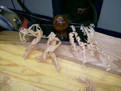

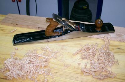

Fine shavings... medium shavings are illustrated below.. after a lot of work. That's all I would have ask for in any plane. Sometimes you just have to weigh the value of the journey.
