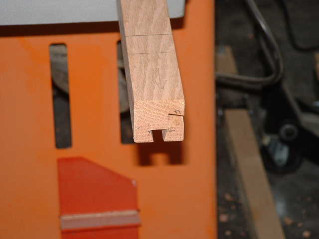

    All of the following assumes you've milled your legs to size and have your joinery figured out. In this case I'm using sliding dovetails for the apron to legs, so I did all of that milling first.

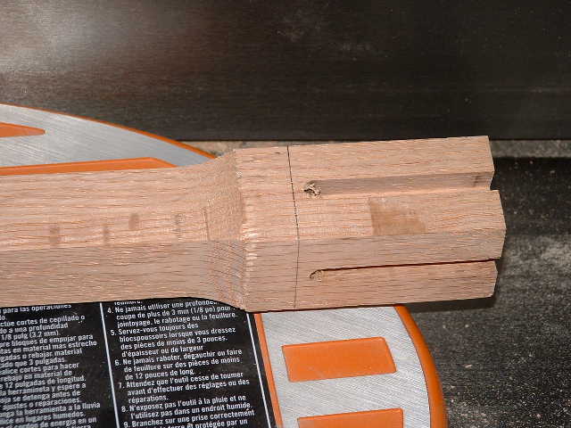

    The legs I'm doing are 1 1/2 x 1 1/2 red oak, I'm using a 5/16 depth of cut on the jointer. You can change the depth of cut if you find you're not comfortable with that big of a bite, you'll just have to make more passes. (fair warning tho', red oak isn't the nicest stuff to work with when trying to do legs this way. It sounds like a war zone while you're milling.)

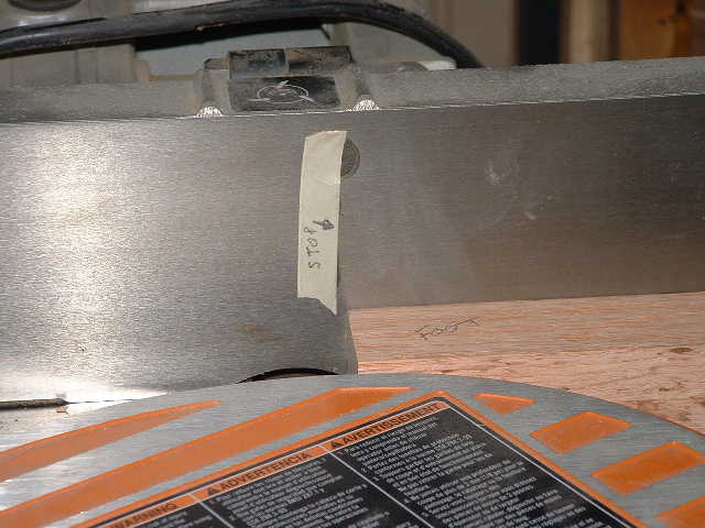

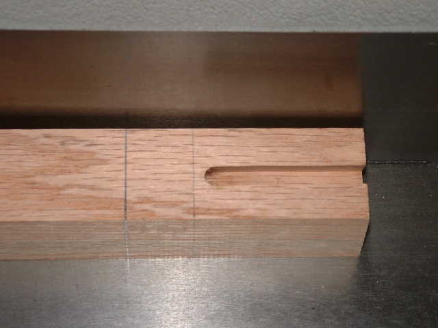

    Step 1: Marking your stops:
    You'll need to mark the top of the leg where you want the jointer cut to stop and then mark the fence just in front of the cutterhead. In my case I marked the fence before I lowed the infeed, it's not really a big deal as this isn't rocket science.

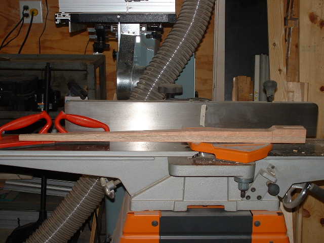

    Step 2: Making the initial cut:
    You'll want to make the initial cut 'foot first' into the jointer head and feed until your stop lines match up.

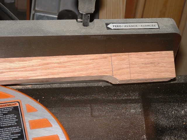

    Take care to make the first cut on the proper side of the leg as it will allow you to have a solid face against the fence when you flip the leg for the second cut. You'll see in the following picture that I place a groove face down and one against the fence. When I rotate the workpiece to make the second cut, what is now the top of the leg will end up against the fence giving me solid support for the second cut.

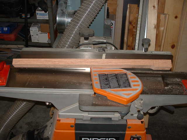

    After you complete this cut, you should end up with a leg that looks something like this.
