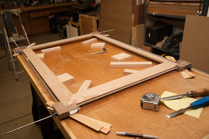

    I have been making some picture frames and as I hadnt made any for a while I had forgotten what a pain clamping them is. For the first one which had quite a thick frame I used a web clamp, they are a bit of a pain but it worked. The second one has much thinner edges and I knew the web clamp would be really tought to use.
    I noticed this from lee valley but wanted to glue up the frame today so made one. It was pretty simple and cost about $15 in parts. I bought 4 x 36" rods and 2 x 24" ones so can use it up to 60" x 24"

    As the rods are > $2 each I can always get other lengths in the future.

        Cool -- I might have to try this one, too. Are you using regular nuts? I noticed they sell the "speed nuts" by themselves for $10 -- sounds like they would make the clamp easier to use.
        Also, how did you attach the other end of the rod to the wood without crossing the path of the other rod?
                      All threaded parts are 1/4" 20 I used these 3 star knobs that were on sale 2 for 1 at rockler today.
                      http://www.rockler.com/product.cfm?page=1574
                      The speed nuts look like a good idea, I may have to upgrade to those at some point.
                      One end of the rod is fixed into a threaded insert that only goes into the corner bracket approx 3/4" so it doesnt interfere with the through hole.

                        Thats awesome, I had forgotten about that jig. I had wrote it down when I saw it with intention to make one of these days You did a good job on yours, share your details when you get a chance.
                        Its pretty much as it looks. COrners were made from some scrap walnut with one through hole (1/4") and a threaded insert in each. See my previous post for knobs and thread sizing.
                        If you need more info let me know.
                          I saw one of those in ROckler today, dont recall how much it was but I couldnt see how you could use it for bigger frames.
                          I got a longer all-thread rod to pull it together on larger frames... works just like the center bolt does in a stock configuration.
