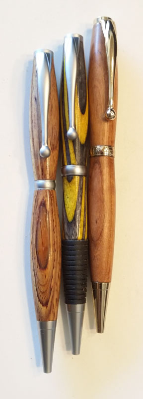

    This weekend I turned the rest of the kits that came with the starter kit I bought from PSI. will be gifts for friends and family when I am on vacation in a week or so. Still learning a lot, mainly on how to destroy blanks with over zealous end trimming and finished turnings when trying to get rid of excess CA glue ;-(
    The photos are not great but here is what I ended up with. From left to right Cocobolo, laminated ply, cherry, Walnut, Leopard wood, Jack Daniels barrel. The horizontal one is Tulipwood and is my favorite. Its actually much pinker than the photo makes it look. Been trying various CA finish combinations and so far the BLO/thin CA seems to go on easiest and makes for the cleanest finish. Still not sure about how many coats. When I try to add some medium ca coats without BLO they seem to lose their sheen and it can be rougher and need to go back to 600 grit sandpaper. I am rubbing out with micromesh pads but seem to have had times when I have gone through parts of the finish.

    Nice bunch of pens Jon, I see you're experimenting with shape on some of the slimlines. I like the Comfort and the Trimlines for their larger centerbands - leaves more wood on the tubes to work with, I just find the slimline centerbands annoyingly narrow. Keep up the good work!
      I bought the 7mm sample kit from PSI and it had the slimlines, comfort, designer and Tec7s. I had 2 comforts and did one with the rubber which I dont like as it makes them look cheap, why bother having a nice wood pen with a rubber grip. If I want something like that I can buy a pack of 5 at staples for $5! Dont use the rubber as in the cherry one and they are basically a fatter slimline and see what you mean as they do feel more substantial. I do quite like the black/gold clip of the slimline though.

        I toss the rubber grips as well. Besides looks, after using for a while, that rubber can get brittle and crack, or sticky/mushy.
        I've done a few different rollerballs, mostly the Woodcraft type like the Tycoon, the Classic, etc. For gifts, I tend to gravitate toward Parker-style ballpoints and Fountain pens though, because the ink is easier to find at common office supply stores; rollerball refills, not so much here by me.

            I think shapes are a matter of preference. I'm more inclined to be subtle with a barrel shape and prefer a straighter line. The waspy look isn't for me. My favorite component set is cigar style for ball point, and I like Berea's Virage for a rollerball.
            There isn't a magic number of coats of CA. I only use thin. I shoot for a final sand before CA so that I'm somewhere around 0.004" to 0.008" less than the mating component diameter, build CA until I'm around +0.004" to 0.008" over the mating component diameter, and then micromesh my way to final mating component diameter. Then I buff lengthwise.
