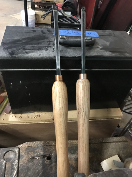

                  Just ordered myself a selection from R.K. Cutters on ebay.
                  https://www.ebay.com/itm/Choose-5-Ca...YAAOSwc2FaLygk
                  "update" Total investment 30-00. Free oak stair tread not best, but its free.

                    Click image for larger version  Name:	rsz_5b882bdd5bef8.png Views:	2 Size:	428.5 KB ID:	834724
                      Nice set of functional tools. Don't forget to share the finished turning projects!

                        Will try. These are for a "makerspace" that I belong to. Someone donated a really old lathe, and worn out tools. Another member donated a bunch of slimline pen kits and blanks, so that's pretty much what people are turning right now. There are 3D printers, CNC and laser cutters, even 2 Maslow CNC machines. Mostly home made.
