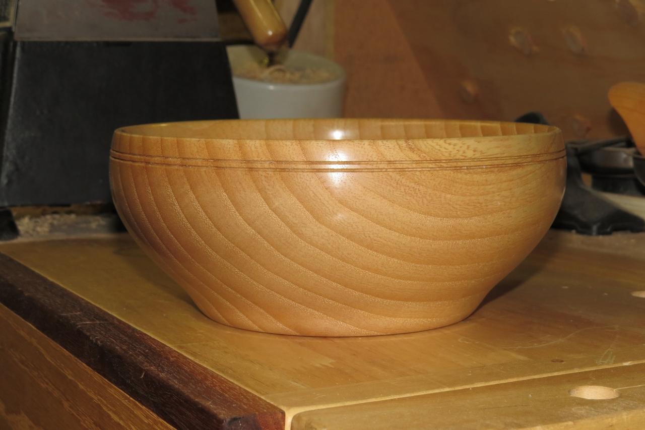

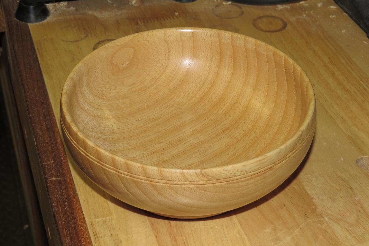

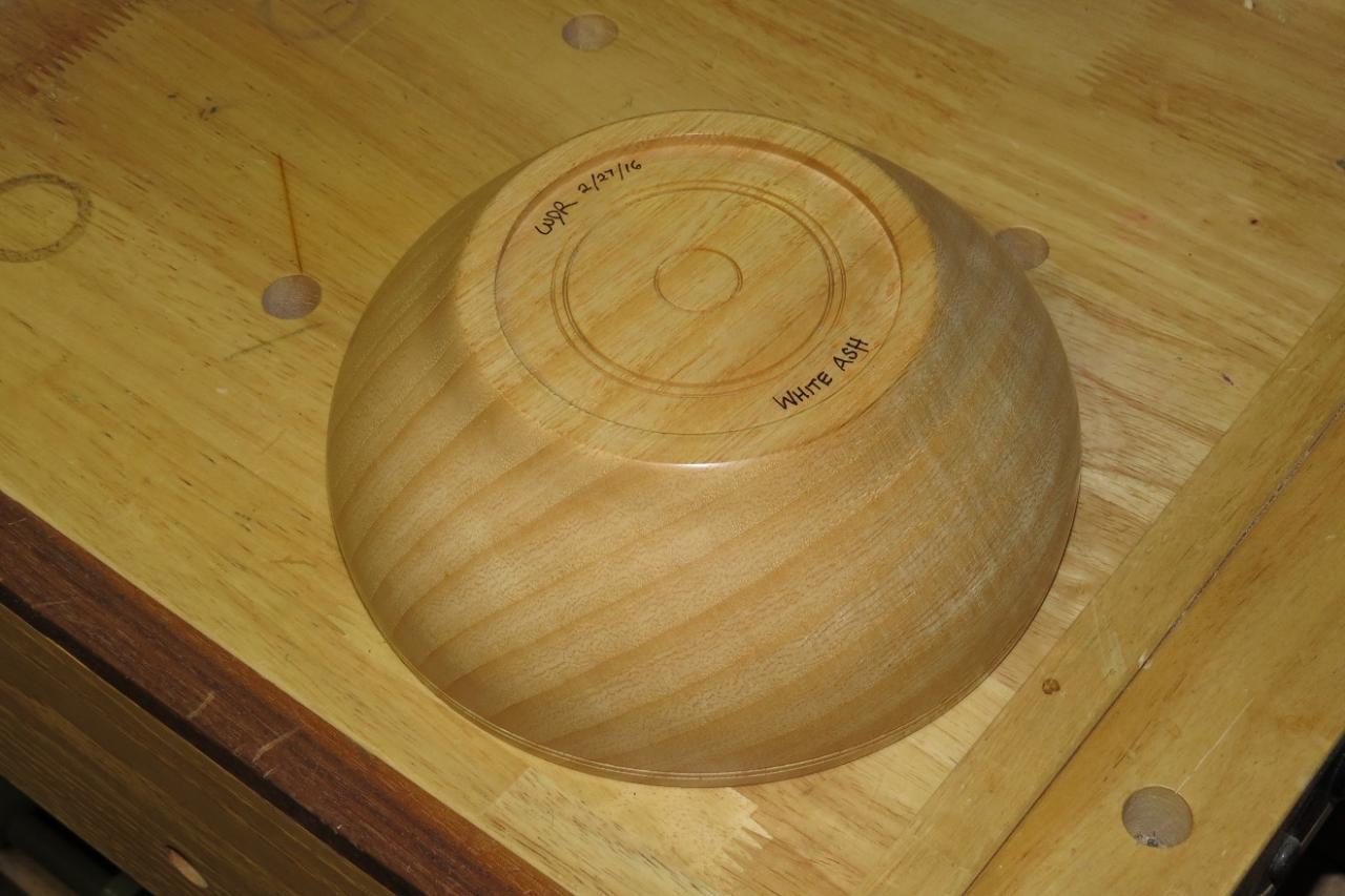

    Turned this one today from the stash of ash I cut up into blanks about 8 or 9 months ago. This is the first bowl I've turned from this ash, I'm still playing with shapes; the rest has been handles, and those pestles I made for the sieve colander. Very dry, very hard, had to resharpen the bowl gouges a few times. Also used my round carbide for hogging out the inside. The aroma of this wood while working reminded me of pumpkin. Sanded through 400, burnished with the shavings, and applied a couple coats of the friction polish. 7.5 inches across, 2.75 inches high. Thanks for looking.

        Thanks for the kind words. White ash I believe is also used to make baseball bats, so yes it's kind of hard. Not as bad to turn as dry oak or walnut which results in more powder than curls when turning.

            For walnut and oak, by "bad" when dry, I guess I mean brittle, not hard. But dry oak IS hard. They may turn nicely when wet, but dry is my least favorite. Even for pen turning, I like how walnut burl looks, and have made some sweet gift pens from it, but its prone to chipping, tear-out and blow-out due to brittleness. I find purpleheart the same. I don't do much in these woods because of that. So the dry ash is hard, but still seems to cut better.

                Nice shape, and I like the detail on the outside under the edge! It looks very even, what too did you use for that?
                  Thanks Gerd. For the detail marks on the bottom and edge, I use my carbide long-diamond-point tool, has one of these on it from AZCarbide: http://azcarbide.com/product/diamond...for-wood-copy/
                  Gives a nice fine point for lines. Wants a light touch and negative approach, can be catchy.
                  Joann, yes, this will also be a gift. I do have a blank or two from this ash that may yield a fruit-bowl yet. Might have to tackle that next.
