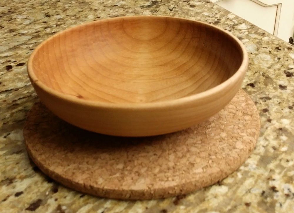

    Well this weekend I used my lathe for the first time and basically I made a lot of sawdust! I did some experimentation and practice with various tools and produced some ugly looking spindle shapes. wasn't really aiming for anything other than seeing what some of the different tools did. had my fair share of catches. I did end today trying a simple bowl and as a first attempt I wasnt too ashamed. The edge did crack and I am not sure why, its not that thin, I think the scrap stock I used has some defects
Name:	2016-01-10 19.22.38.jpg

    Great looking first bowl! And you're definitely in the vortex now
    As for tools, I have the more expensive HF set, and I also have some of the Benjamin's Best from PSI - I would recommend the BB over the HF, the steel just seems to be better. Also, the HF set has no bowl gouges, just scrapers and spindle gouges. You can build up a reasonable set of BB bowl gouges for not too much money.
