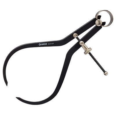

          Aah, I have the conventional dial version of those although a digital version would be good. I was wondering about these types of calipers. Have you ever seen digital versions of these in HF?
