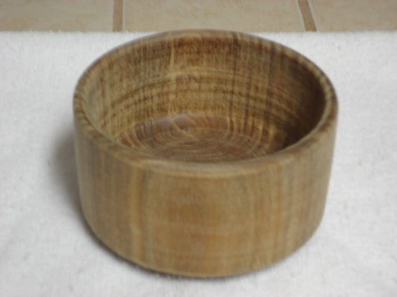

    I finally brought the lathe home from my dad's last Thanksgiving. After some rehab and a turning class this spring, here are a few pics. I have half a dozen other bowls drying, plus I've made some mallets and even some funnels. I also turned a vase and some tulips for my wife but no pics yet.
    My first bowl, an endgrain mystery wood.
