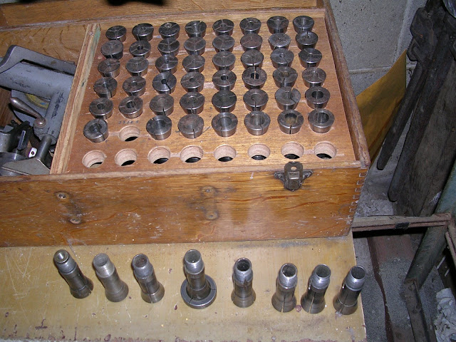

    It may look a bit odd but it came with an army of tooling

            I have collets for most anything from 1/16 up through 3/4" so the drill chuck mandrel would be the way to go..

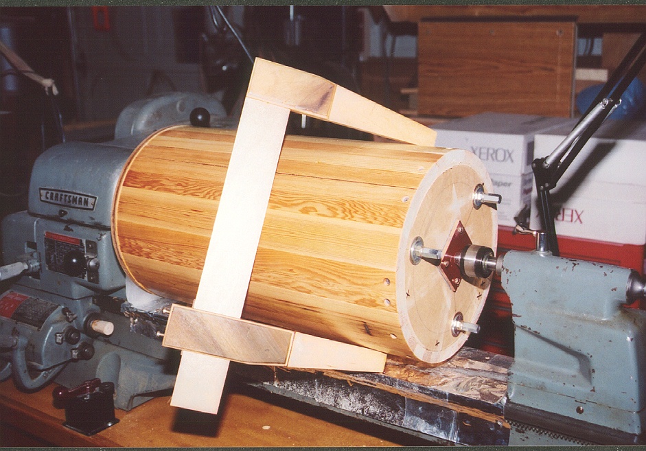

                    wood turning on a metal lathe
                    A metal lathe works good for turning large diameter wood objects because the of the low speed.
                    Some directions for turning and polishing small diameter wood objects call for about 3000 rpm which is not available on most older metal lathes.
                    I made a mandrel to turn a wood drumcase for my wife's ceramic drum

                      I looked at the Woodcraft Professional Pen mandrel.. All I really need is the replacement shaft, nut and some pen bushings. My Lathe is already equipped with a collet to hold it.
