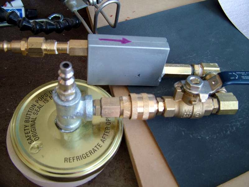

              There is a filter on your pump and/or line correct? I use an air compressor and a venturi. I do have a 12v tire pump I need to finish that will be vacuum only for this purpose.
              Are there better solutions to stabilize with? I've heard of using straight poly, but the acetone+plexiglass method seems like it's work better.

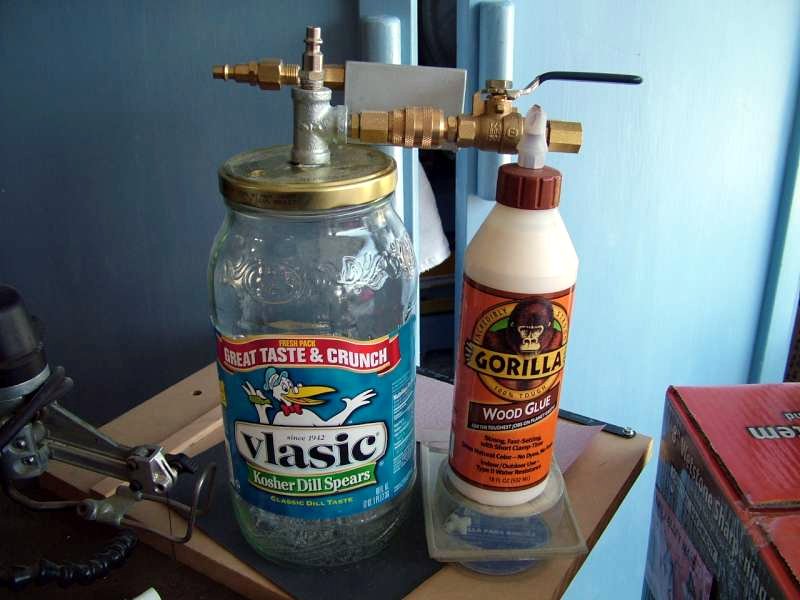

              I've used plexi + acetone, plexi + MEK, white construction foam + acetone and I've used Minwax Wood Hardener.
              But for a home-brew what I currently use and thanks to Russ Fairfield for doing a demo on this at our club meeting is simply White Carpenters Glue and water mixed 50-50.
              I fill the pickle jar with this mixture and add the blanks and then apply vacuum and in 10-15 minutes the wood is penetrated (stops foaming) and I pull them out and set aside to dry.

                          The TT I use is yellow tinted. The pic in the first photo is Gorilla Glue that I got at HD and is white.
                          HD has it in 16oz size for $5.87 and Walmart carries it in 8oz for around $4.00
