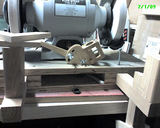

                                #30
                                I found some plans on the internet that had a gouge fixture and plywood base like the one above. I really like it and it gets alot of use. Unfortunately the guy who put the plans up passed away and the website doesnt exist anymore. You can get an idea from here though.
                                http://billswood.blogspot.com/ more pictures
                                Found the plans! They are here: http://shapewood.co.uk/Documents/sharpe1.PDF
                                The vari-grind fixture are print and stick and cut! The guy had real talent...
