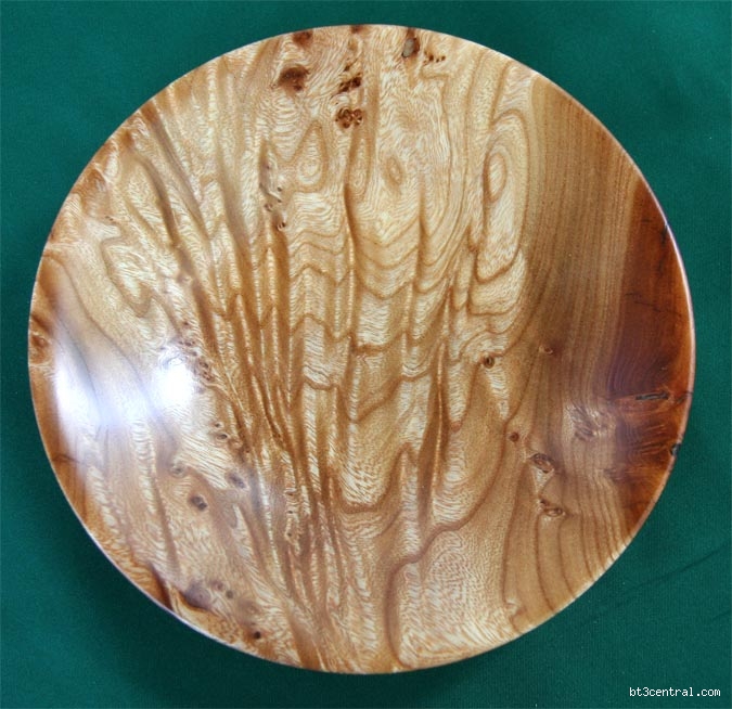

    Well, I decided to try turning something outside of pens. I had a Japanese Elm (Keyaki) board that had some beautiful grain in the crotch (mostly sapwood). I cut the basic circle and turned it. Beautiful grain showed up.
    This is my first plate and it is 6 inches in diameter. First picture was taken from an angle and to the un-initiated it looks oval. I don't have an oval lathe yet, so it was the camera.
    (CLICK on each pict for a larger view.)
    Overhead to show that it is "round". I must say that carving those grooves in the wood to make the valleys was difficult, but I managed.

    It's a striking piece, Hank. Absolutely nothing there at all to be ashamed of. Keep 'em coming...

      Wow. You decided to "try" something different. It looks like you did more than that. Great job. What finish did you use?
      My first thought when I saw the first picture wasn't "oval", it was that it looked more like a bowl than a plate.
          The wood was very dry and somewhat brittle. I turned it to rough size but it splintered easily. I put it in a pressure pot, set it in a bowl of Acetone melted acrylic and pulled a vacuum for 30 minutes. After it set for a couple of days, I turned it down to size and it turned much better. Then sanded.
          Finish was several coats of tung oil over the period of 10 days. Hand rubbed and waxed.

            WOW. Isn't it amazing what can hide inside a piece of wood. Beautiful, Hank

                Wow, that's a nice looking piece! And the simple elegance of the turning is just the thing for that wild grain.
