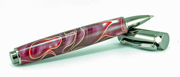

    This is my first attempt at a Zen from CSUSA. It's a black t/n kit with a purple passion blank also from CSUSA.
    It's real a fun and easy pen to do.

    Looking good!!!

      That is a neat looking pen. LOML like the Purple Passion and the Purples from CSUSA, she grabs them every time I make one. May have to try a Zen. I am reall starting to like the Black Ti plating it goes well with many different blanks.
        Looks good, Dick. Just a quick heads-up about the Zen... It makes a better desk pen than a carry pen. This is because over time, it tends to get where the cap comes off in your pocket. It's a common problem with many loose-cap designs, and even happens to some of the threaded-cap pens.

          Isn't the Zen one with a magnetic cap retainer? Even so, the cap comes off?

            That is a very cool looking pen. Nice work.

              Yep, it sometimes does... Usually when you least expect it to... Plus, it picks up all kinda metallic junk if you carry it in a pocket or purse...
                Really well done and very unusual. Almost too pretty to use.

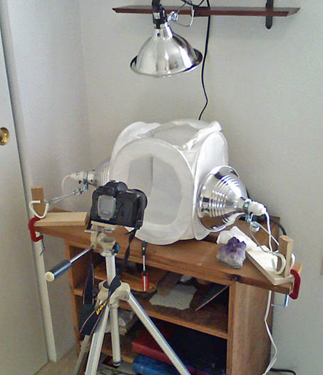

                  VERY good looking pen and exceptional photo! I am about to post a pen photo but your has intimidated me!
                      I can certainly picture that - bleck. Thanks for the tip!

                        Nice looking pen has a kinda lava lamp vibe about it.

                          I have been photographing since about 1950 and have just recently relearned some of the basics that I had forgotten.
                          I use a Nikon D70 DSLR with an 18 to 70 mm zoom lens, most any digital camera will give the same results.
                          I use an inexpensive light tent which cans also be home made. Lighting is with 3 27 watt photo correct fluorescent bulbs in 8 1/2" reflectors.
                          Set the camera on manual, frame your shot, take your meter reading on a photo grey card and set the exposure (I try to keep the Fstop at F18) , remove the grey card and shoot.
                          I do run the picture through Photo Shop to crop, re size and hit it with the unsharp mask and retouch if necessary.
                          There is a good tutorial on this site: www.nealaddy.org
                          Here is a picture of my studio.

                            You have a GREAT setup! I like it. I wish I could find some "photo correct" bulbs over here. I probably could but I just don't know what to ask for in Japanese.

                              Look for any bulb that is rated at 5000K color temp.
                              Here is a link to a source.
                              www.bhphotovideo.com the part # is GBFS30Z
