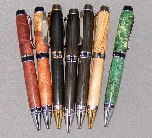

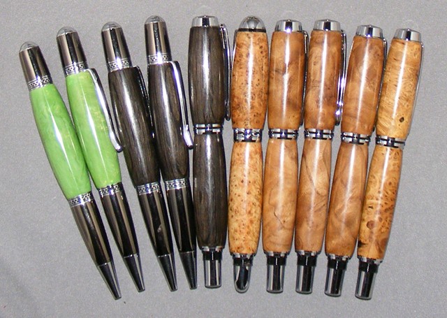

                        Great set of pens Mike! Great fit and finish!
                        Question for you, and others: When you make a batch and one particular pen stands out - to you - do you decide to keep it for yourself, or at least use if for a while?
                        I kinda have that problem. But when I am working on a single pen or two for specific people, I do let those go.
                          I have a display for one-offs or for the last examples of a limited edition. If I do something made-to-order for somebody, I go through with giving to them, even if I wish I didn't have to. Some I just hate to part with.
