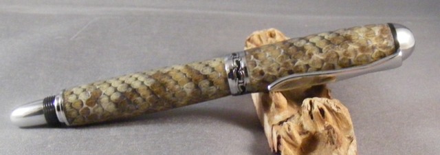

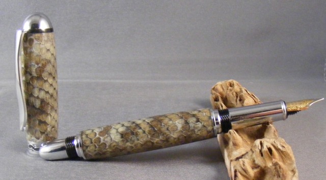

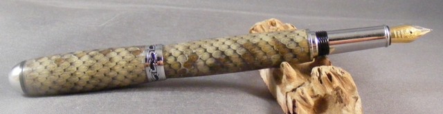

    A friend sent me the blank for this fountain pen. It was an experiment and I'd say a successful one.
    Prairie Rattlesnake Skin on a Chrome Sedona Fountain Pen. I think I'll retake these pics on darker background, the pen in gorgeous in person and the pics don't do it justice.

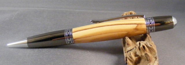

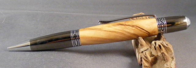

    And Two "BOWFish" Bethlehem Olive Wood on Two-Tone Christian Fish Pacificas.

    Very nice Mike, a very nice combination on the "BOWFish"

      Rattlesnake skin? Is it cast in resin or something so you can turn it? You are right - that is a gorgeous pen.

        Yep. the skin is glued around the tube, then the ends are plugged and the whole thing is cast in PR. Then you trim to length and remove the plugs and on the lathe it goes.
        You have to be a bit careful at the ends of the blank as the thickness of the nib can be close to that of the skin. As I mentioned, this one came from a friend, but you can buy them from www.ArizonaSilhouette.com (Rattlesnake blanks) or from www.Glimmerznmore.com (Python and Cobra).

          Personally, I don't think BOW is the best wood choice for the Pacificas. Maybe it's the picture, but, the wood seems a bit too light for the amount of dark hardware.

            Cool Pens Mike, The Snake skins are really nice. Like the BOW also but wonder if the BOW would look even better and the Two Tone TiGold kit that was offered? I was tempted to get some of the other plating but was talked out of it during the discussion on the Group buy. May have to order a couple to see what they look like.

              I got one of the Gold/Black Ti kits during the buy to prove to myself if they were good or not. They look fine, but I messed it up when I was trying to knock the blank out of it. I then tried a quick experiment. I took a buffing wheel and hit the surface of the gold, the black Ti, and the chrome on another kit. The gold weas eaten pretty wuick, the chrome and black ti held up nicely.
              I think the non-TI gold's are okay for gifts, but I wouldn't try to sell them.
