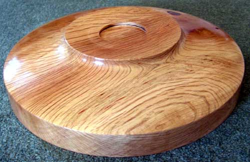

      You can vary your holding technique only according to the type of chuck and jaw sets that you have. A spigot (or round tenon) needs turning as the outside is shaped - either when the bowl blank is mounted on a faceplate or a screw chuck. When it's reversed for hollowing, you can then either pare it off, or pare through until you're happy, then saw it off and sand flush.
      I've got a set of external dovetail jaws for my chuck, so I tend to use a dovetailed recess to expand my jaws into. These can either be left as a "feature" (good place to sign the work and note the species and date), or turned off with the bowl held in a set of Cole jaws.
      Here's a picture of a 15" diameter holm oak bowl with such a recess shown. I tend to dish the base, so that it will sit nice and flat.
      HTH Ray.
          HTH Ray.
          [ATTACH]7362[/ATTACH]
          Nice bowl --
          One comment that I'd like to make about the tennon is that larger is not always better. Notice the depth of the dovetail recess in Ray's piece with respect to the overall size of the bowl? My guess is that it's only about 1/4" to 3/8" ...
          A tennon for fairly good sized bowl needn't be much "deeper" than that. With the dovetail, squeezing down an a really deep tennon will have a tendency to get pried off the base of the bowl. especially if the tennon is near the max capacity of the jaws.
          What is important though is that the tennon and chuck be all squared up.. One good technique is to turn the tennon with a 1/4" step. This step provides a paralelll surface that will mate to the outemost edge of the jaws. _____
