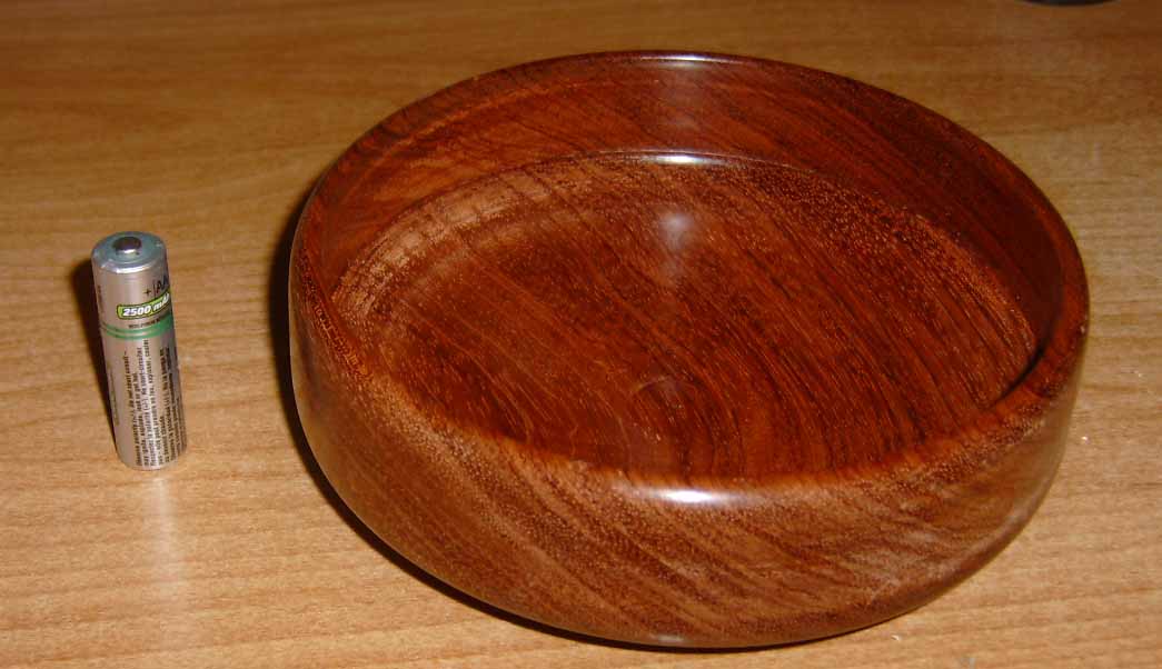

    Ok. Made my first bowl out of bubinga. Its my second try. I left it thicker so it wouldnt explode. Nothin fancy. Well I put friction finish on it and it turned out nasty. Guess I should resand and use poly.
    But heres the problem. I still have my little tennon left from where I held it in the chuck. How you supposed to get rid of that? Do I have to buy the big thing to hold the bowl upside down? Or I guess make something out of scrap with a slot to jam it in right?
    It looks more like a lid to a cookie jar or something...

    Looks to me like you have some tool chatter inside (top left corner of picture?) that messed up your finish. Hard to see that until you apply a finish because sanding makes it look OK.
    If I'm seeing things I apologize, but just trying to help. I had exactly that just last night. Then I blew the bottom out of the bowl...OOPS!

        Originally posted by bigsteel15
        Looks to me like you have some tool chatter inside (top left corner of picture?) .
        Does that mean my tools are to dull?
        It was like it was not perfectly round. like when you start to round it but obviuosly no where near that bad.
        There is a spot on the outside like that too. I sanded forever too...I need a bigger gouge and a scraper. The bigger gouge to hollow it out faster( i think) and a bowl scraper would make it smoother (I think)
          Looks good for the second bowl.
          I go with what Don said, throw together a jam chuck and turn the nub off. Make the bottom concave so the bowl will set flat on the rim. If you had a rough spot or two, try using a round nose scraper with a real light touch. Now you have a reason/excuse to get another couple of chisels!

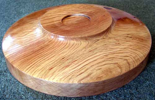

            I tend to use a dovetail recess to reverse my bowls. Here's an example from a very large holm oak bowl:

            The chuck jaws expand inside the recess and offer good gripping. You'll hear some tales of bowls breaking apart under this internal pressure, but I'd guess that's mostly caused by other factors as well - never happened to me (yet!).
            Cutting a spigot can never suffer from such problems, of course, but you then have to turn it off. If you're not prepared to part it most of the way, then knock it off and pare the nub, the only way is a jam chuck or a set of Cole jaws. You can make your own Cole jaws fairly easily - there are several plans out on the Internet if you have a poke around. Here's one set for you.
            I bought a large set of Cole jaws with my lathe, but rarely use them because I use the dovetail recess. When I do use them, though, I'm careful not to run them too fast and get the turning done as swiftly as possible to prevent any scuffing to the inside finish.

                    Well I took a piece of plywood and made a big circle. Took my parting tool and cut a groove (first try was a success) and pushed the bowl into the groove....got rid of the tennon and have a coat of poly on it now.
                    I thought id make another one out of walnut. I thought hey let me try this screw. After I had already started between centers. well it got pretty wobbly and I made the inside cut instead of a tennon. It stayed pretty wobbly through the entire thing. Then not taking into account the chuck was not much closer I went through the bottom and there was a tiny hole...No big deal until all of the sudden it became a huge hole the size of the inside of the chuck...
                    So I have one bowl out of three attempts..I guess once you start a piece you shouldnt change the way its mounted huh???
