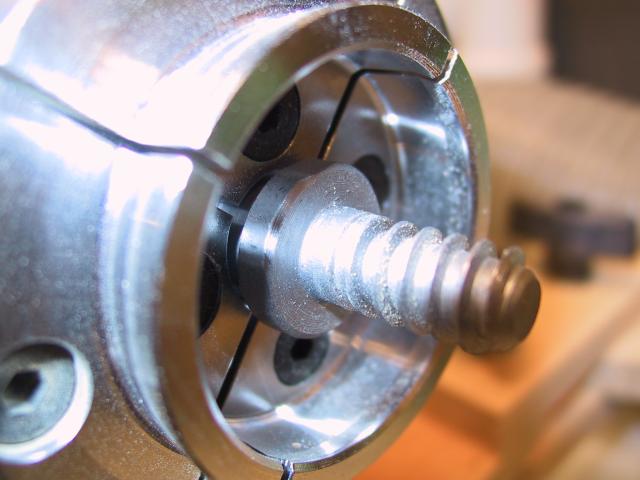

                        OK, I snapped some pics:
                        This one shows the screw partially captured in the jaws. Note that a portion of the jaw bottom fits into a recess in the screw.
Name:	Screw Partially Captured.jpg

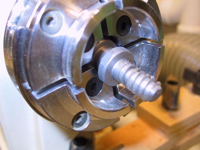

                        Then, snug it up a bit, but still allowing a little back-and-forth movement, and pull it forward.
Name:	Screw Pulled Forward.jpg

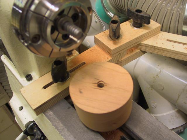

                        Drill appropriately sized hole in your blank (this one has already been roughed).
Name:	Hole Drilled in Blank.jpg

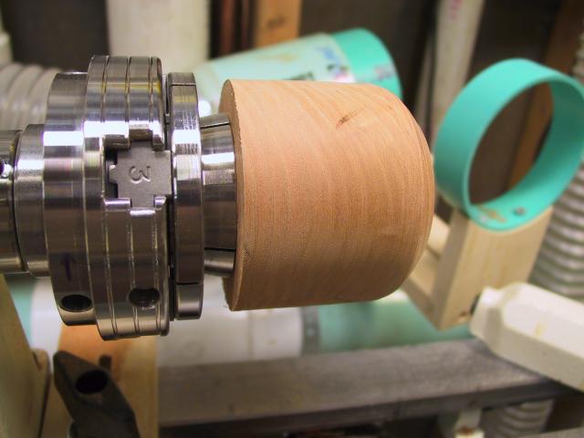

                        Mount the blank onto the screw, and be sure the screw is pulled all the way forward when the blank is snugged up to the jaw faces.
Name:	Blank Ready.jpg
