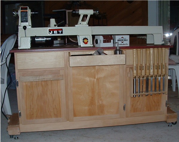

    I'm not a turner, but saw the need to make an occasional spindle when I bought Ginger's lathe so I added the bed extension.
      Typical Gunny.. Give em an inch to work with and they'll squeeze out a mile! :>)

          Pappy that cabinet you built for Ginger's lathe is a work of art. I saw it earlier in the completed projects section. Mind building me one too? =) Does Ginger like the lathe so far? Would she recommend it? What is the real working max capacity in terms of diameter? Is it worth getting the variable speed model or should I stick with the speed change by spindle model. Sorry for all the questions. I feel very lucky that a veteran member has had first hand experience with the lathe and definately want to take advantage of your experience. Thanks!!
