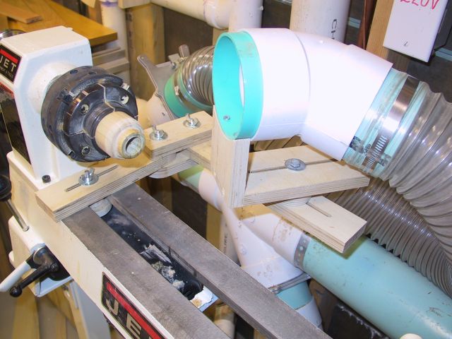

          Here's something I put together for my lathe. It attaches to the lathe bed, with a big homemade washer underneath. It's articulated so that it can keep clear of the banjo, and still come up close to the workpiece.
Name:	Lathe DC Fixture.jpg
          It works well, is easy to position, and holds its position well.
          I don't try to collect chips; I only run the DC when sanding and finishing.
