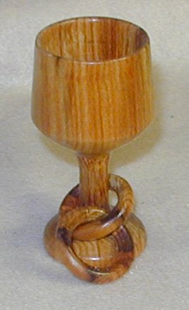

        A real good starting set is this 8 piece set from HF:
        http://www.harborfreight.com/cpi/cta...emnumber=47066
        They are surprisingly good for the price, too bad there's not a bowl gouge included. Then add Robert Sorby or Crown as the need arises and you learn what you are comfortable with. One tool I recommend is a good hollowing tool such as the Sorby Hollow Master.
        My condolences on your new addiction, there's no going back!
