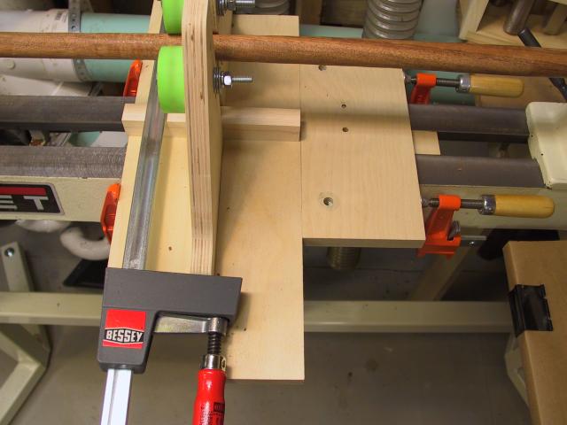

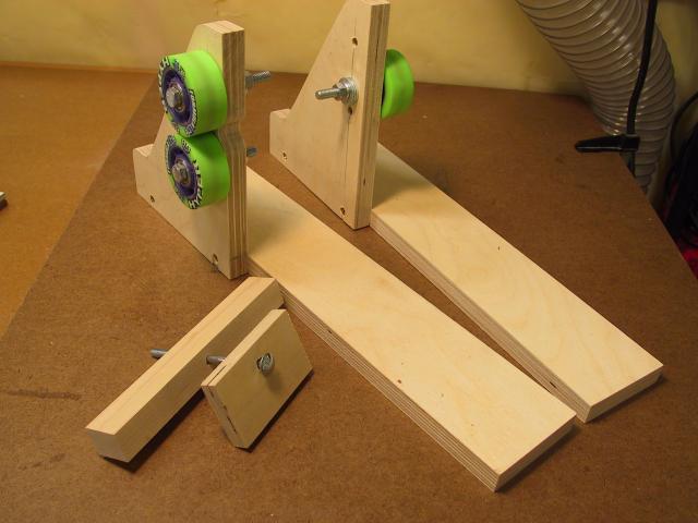

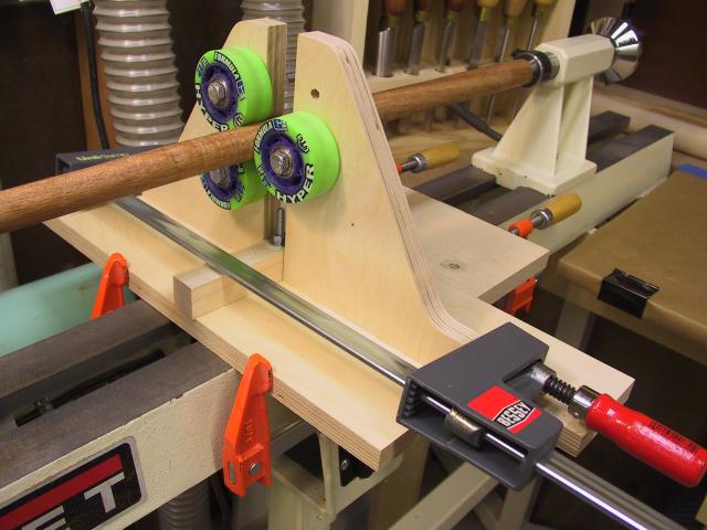

      I made this one a while back -- wanted something that could go on and off easily without disturbing the turning. It's not quite finished; I plan to replace the clamps with additional hardware, but you get the idea.

          Originally posted by tribalwind
          tom's got summa the kewlest simple jigs
          I try to stay simple-minded....
          id guess the clamp gives you nice tight contact.!
          That's one of the nice things about this setup -- you can set the desired contact pressure, and then clamp the thing down to the bed. So setting the pressure doesn't skew your alignment.
          The wheels I have on this thing are way too spongy, though. I didn't have a good feel at the time for what I wanted. Some folks, I think, just use straight bearings for spindles, but that seems a little too hard a surface.

              Uh, yeah, although it was pulled out of the way for the photo, it'd go on the left side in the setup shown. Or, you could flip the steady 180 degrees and put the banjo on the right, taking advantage of the easy-on easy-off. Actually, what I'd do first is reduce the footprint of the parts, replace the kludged clamping with fixture hardware, etc. etc.
