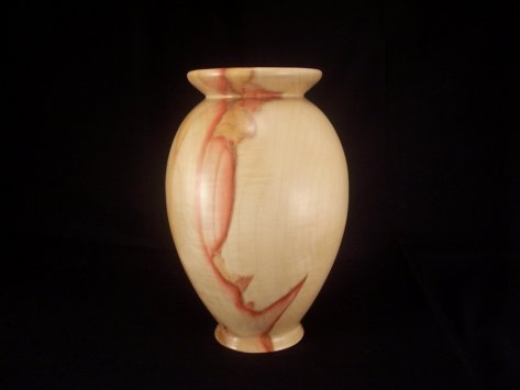

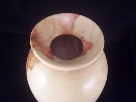

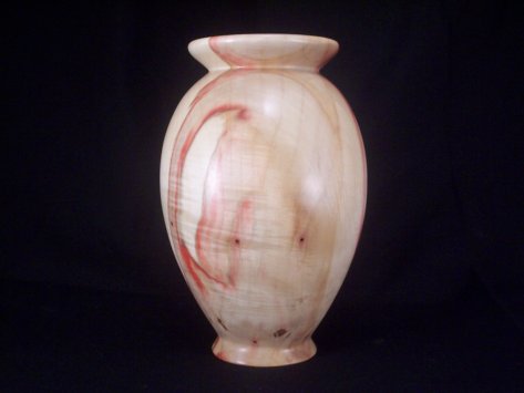

    Here is the first out of another batch that me and My Little Lumberjack got.
    This one has some nice Red Flame and a little curl.
    It measures 8 3/4 high X 5 3/4" tall
    Finish is wipe on gel poly and buffed on the Beall.

              Thanks all.
              boblon
              I use the DNA method for drying all my green turnings. It works Great!
              zootroy
              It is Box Elder with Red Flame.
