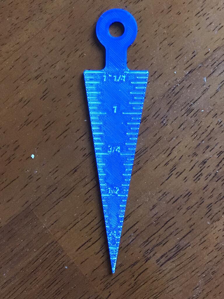

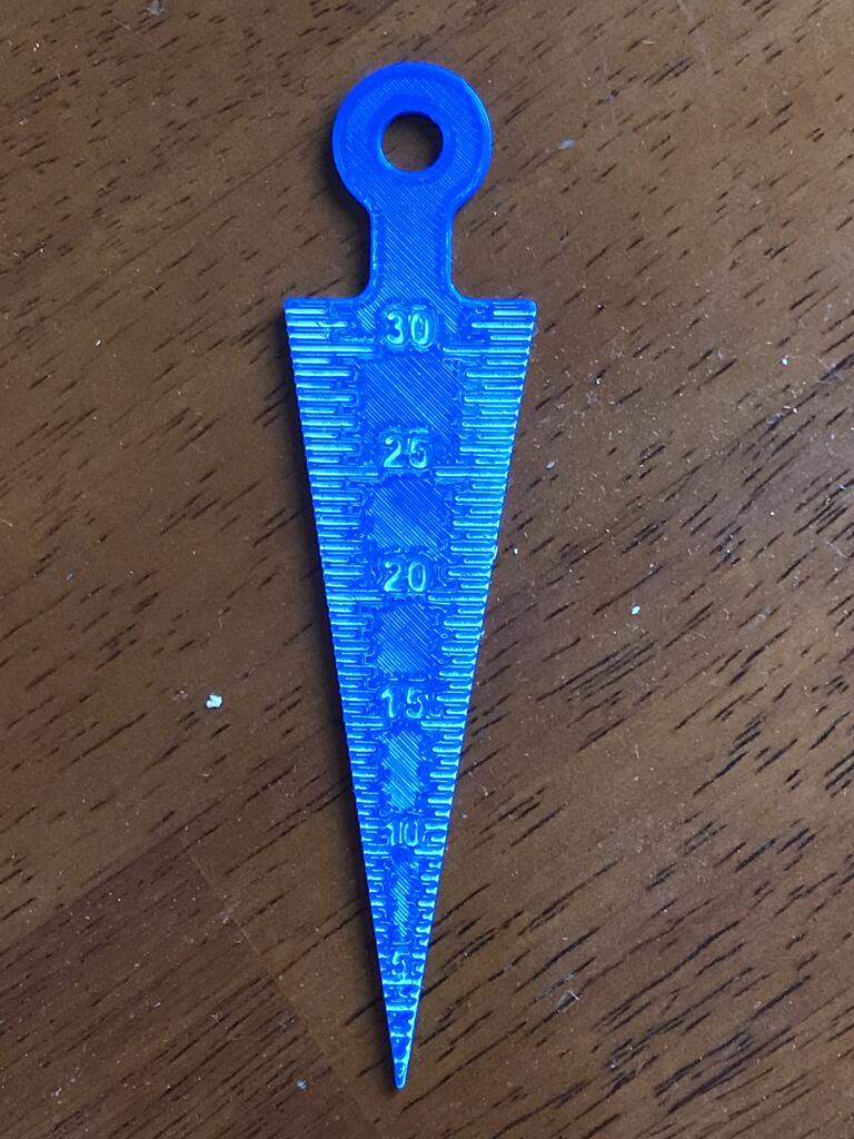

    Hole Diameter Gauge - mm & inch
    STL was found on thingiverse - HOLE DIAMETER GAUGE (mm & inch) by JHON_DOOM_MAKER - Thingiverse

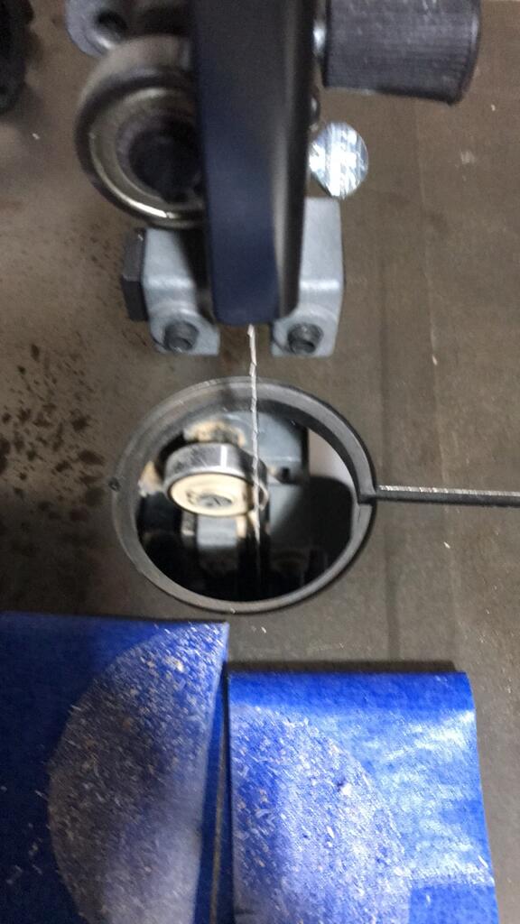

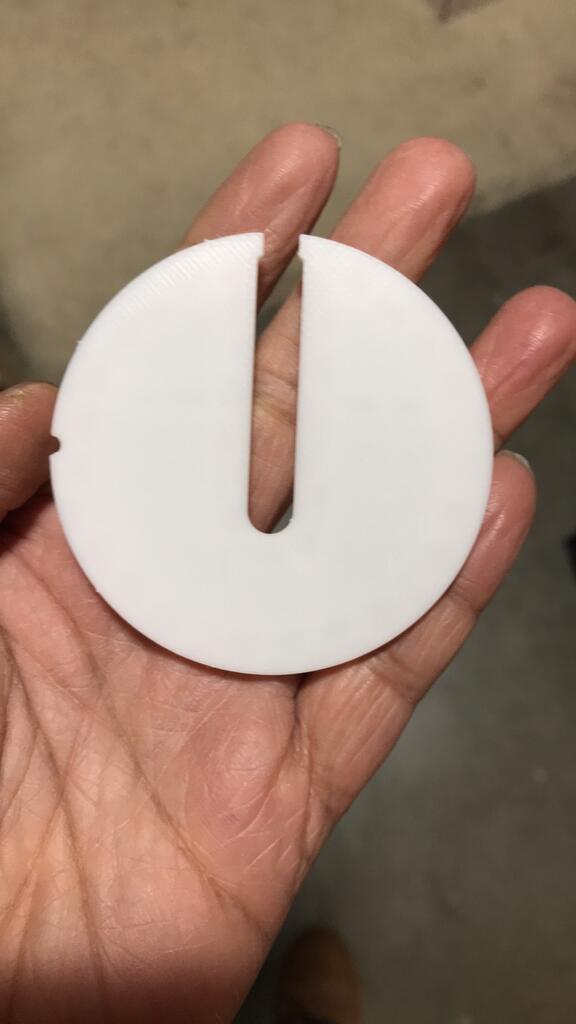

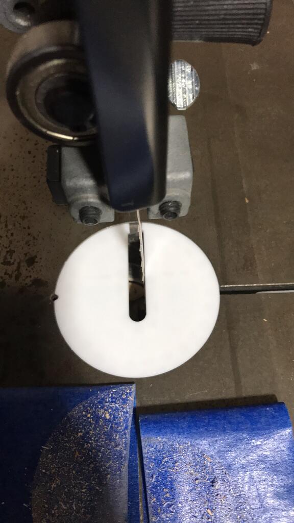

      Bandsaw Throat Plate - Porter Cable 14" bandsaw
      STL was found on thingiverse -Table insert for a Porter Cable PCB330BS Bandsaw by Descotti - Thingiverse
      Works perfectly for my Porter Cable model PCB330BS. May work for other similar 14" saws but not sure.
